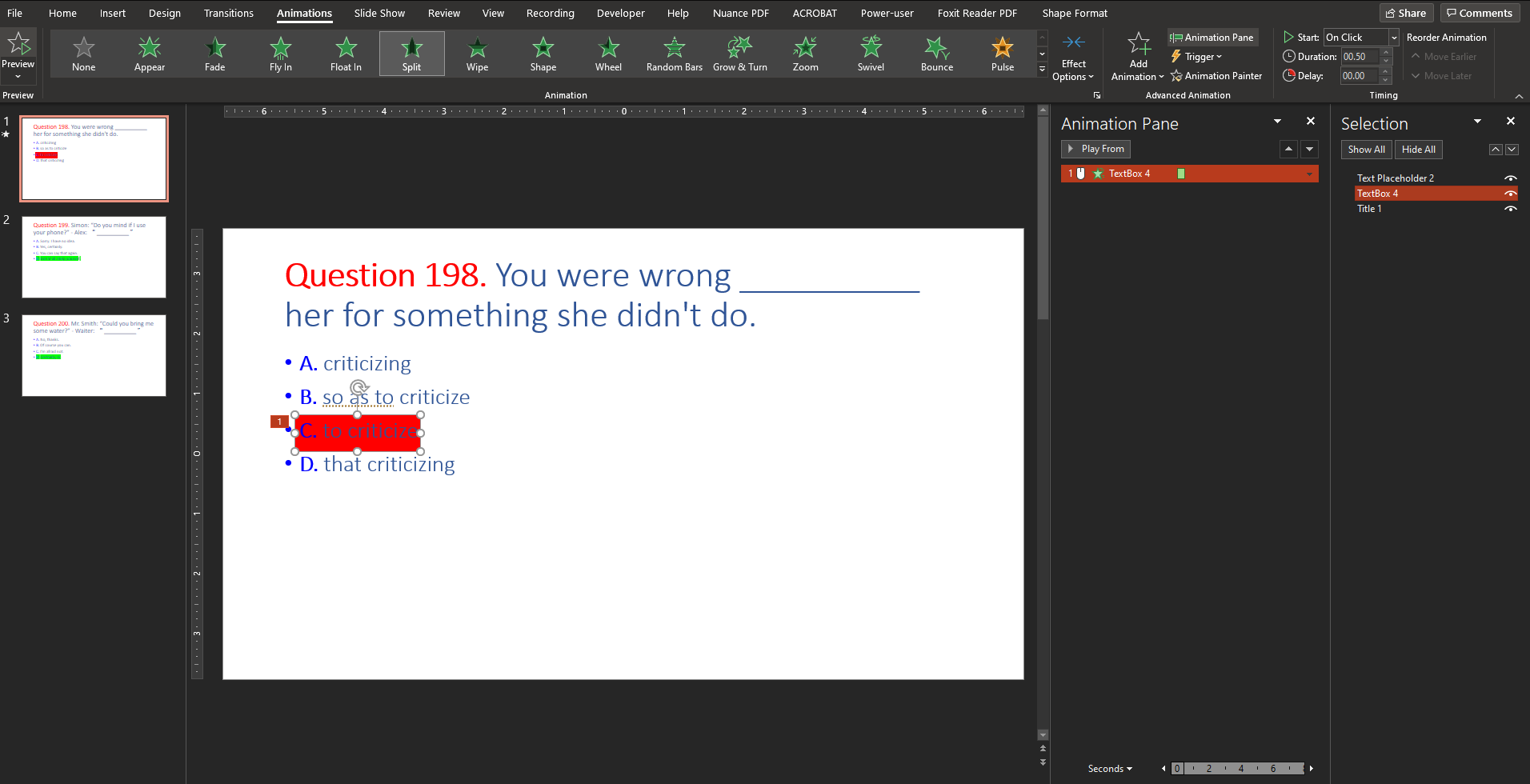

I have this Powerpoint file. Here the link:
https://drive.google.com/open?id=1JaRrBDOEKkCnxeGHrynwdmhPtaOZ8Y4f
I have turned a MS Word file into Powerpoint file using the instruction in this video:
https://www.youtube.com/watch?v=7oao6EzF08U
I want to unhighlight the text, then add a new text box (Red shape fill and Send behind text) with ANIMATION effect, put it in the position of the unhighlighted text like in the pictures.
Therefore, I can show the correct answer to my students when teaching using PPT.
I have about 100 slides like this but I don't have enough time to do it all manually.
Unfortunately, MS Powerpoint doesn't have Macro Recorder like in MS Word and I also don't know much about VBA code.
Is there any way to use VBA code to solve this problem?
Thanks in advance.

    I'm assuming you have 365 or 2019 because 206 doesn't support highlights in PPT.
    To the best of my knowledge it is not possible to remove highlights correctly with vba but you could try this code to Add Red Shapes
    Sub AddShape()
    Dim osld As Slide
    Dim oshp As Shape
    Dim oshp2 As Shape
    Dim otr2 As TextRange2
    Dim P As Long
    Dim BL As Long
    Dim BR As Long
    Dim BW As Long
    Dim BH As Long
    Dim ZOP As Long
    For Each osld In ActivePresentation.Slides
    For Each oshp In osld.Shapes
    If oshp.HasTextFrame Then
    If oshp.TextFrame2.HasText Then
    Set otr2 = oshp.TextFrame2.TextRange
    For P = 1 To otr2.Paragraphs.Count
    If otr2.Paragraphs(P).Font.Highlight.RGB <> 0 Then
    BL = otr2.Paragraphs(P).BoundLeft
    BT = otr2.Paragraphs(P).BoundTop
    BW = otr2.Paragraphs(P).BoundWidth
    BH = otr2.Paragraphs(P).BoundHeight
    ZOP = oshp.ZOrderPosition
    End If
    Next P
    End If
    End If
    Next oshp
    If BL>0 Then
    Set oshp2 = osld.Shapes.AddShape(msoShapeRectangle, BL, BT, BW, BH)
    oshp2.Fill.ForeColor.RGB = vbRed
    Do
    oshp2.ZOrder (msoSendBackward)
    Loop Until oshp2.ZOrderPosition < ZOP
    osld.TimeLine.MainSequence.AddEffect oshp2, msoAnimEffectAppear
    End If
    BL=0
    Next osld
    End Sub
    Once done you could kill the highlights by choosing OUTLINE view, select all the text in the outline pane and choose No Highlight color.
    WORK ON A COPY!
