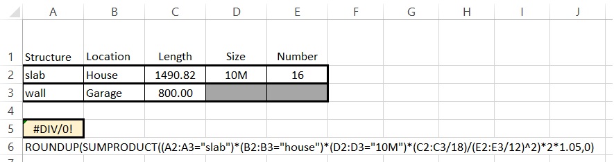

I'm relatively basic with excel.
I'm trying to calculate a Sumproduct with division and will have =0/0 situations, this results in #DIV/0!. How do I tell the formula to ignore these results and continue dividing the remaining numbers?
My actual spreadsheet has 50+ rows and a variation of rows have blank (greyed out cells) under D & E because values are not required. And I really do not want to add anything to these cells.
I'm looking for a function that can be inserted into the formula below? The answer (in yellow box) should be 98.

Try below:
=SUMPRODUCT(IFERROR((A2:A3="slab")*(B2:B3="house")*(D2:D3="10M")*(C2:C3/18)/(E2:E3/12)^2,0))*2*1.05
Use the ROUND function on the above:
=ROUNDUP(SUMPRODUCT(IFERROR((A2:A3="slab")*(B2:B3="house")*(D2:D3="10M")*(C2:C3/18)/(E2:E3/12)^2,0))*2*1.05,0)

    Great thank you Amit!! I did try using this formula, but I narrowed it to the (C2:C3/18)/(E2:E3/12)^2 portion only and was having no luck. Thanks!
