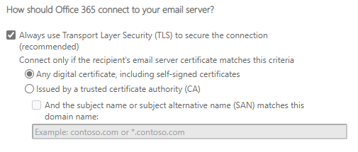

  1. KyleXu-MSFT 26,396 Reputation points
    2021-08-09T02:02:24.577+00:00
    @Marc
    Are you using a hybrid environment?
    If you aren't using a hybrid environment, you could create send connector without a trusted CA certificate. Try to modify send connector connector to:
    Indeed, if you aren't in hybrid, you don't need to create any send connector, Exchange online could send email to Internet without send connector.
    If you are using a hybrid environment, a trusted CA certificate is needed. You don't need to create connector manually, just need to run HCW, this program will configurate connector for your directly.

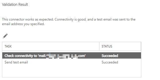

  2. Marc 631 Reputation points
    2021-08-09T11:43:11.443+00:00
    About hybryd.
    If users will be added to on-prem to M365 (AD Azure connect) can I consider we are in Hybrid mode?
    The validation has been solved removing from bothend the TLS security.
    QUESTIONS: This setting worked because we are not in hybrid mode or because uncheck TLS we don't need a certificate (even we are in hybrid)?
    Thanks
  3. Andy David - MVP 158K Reputation points MVP Volunteer Moderator
    2021-08-09T11:47:18.92+00:00
    No, hybrid mode is when you have run the hybrid wizard and you require mail flow between on-prem and Exchange Online mailboxes to be treated as trusted.
    As I mentioned above, that requires a third party certificate
  4. Marc 631 Reputation points
    2021-08-09T12:20:30.847+00:00
    Thank you.
    then we are not in hybrid mode as the mailboxes are on-prem and not moved to Exchange Online. We moved all users to use some service as Teams and we are implementing EOP antispam.
    Probably this is why it worked in that way.
