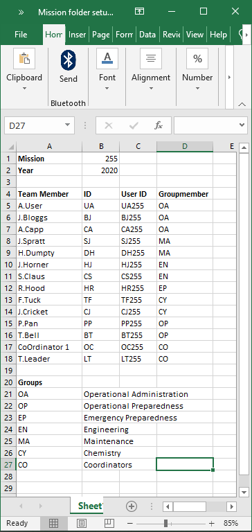

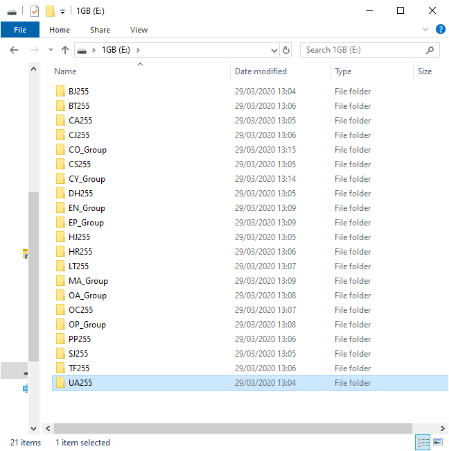

I regularly need to create a folder structure on a drive, which would have a folder per user, with only RW access to that user (+ admin), plus a set of group folders, for shared work, with RW access to the members of that group.
I would like to organise this using Excel and VBS. The following spreadsheet structure:
Resulting in a file structure as below on whichever drive is specified:

    Hi Alan
    I partially reproduced your scenario
    Please, find in the link below a file with the answer to your question.
    https://1drv.ms/x/s!AjGRD1TlwpAGlifDRTRzpONv51ir?e=9MmJOj
    Notes:
    Minor changes.
    1-Group List was moved to allow to input more Team members therefore create more folders.
    2-Cell B4 to Input Directory Path whichever drive you specified.
    3-The file has 2 macro codes,
    a)- Macro "Make_Folders" will do exactly as you requested.
    b)- Macro  "Make_Folders_And_SubFolders" will create the Group Folders and then create the User ID SubFolders inside the corresponding Group Folder
    Macro 2 RESULTS
    The codes
