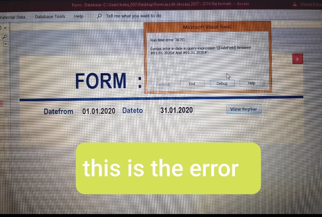

    Thank you very much for your kind response. I tried your code but did not work. I got a runtime error 3075.

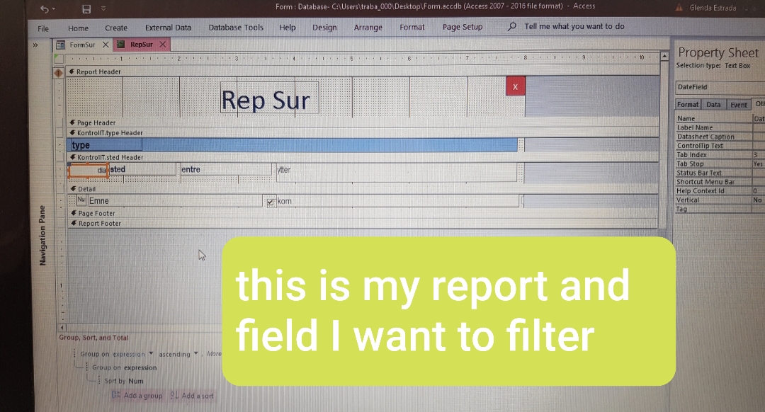

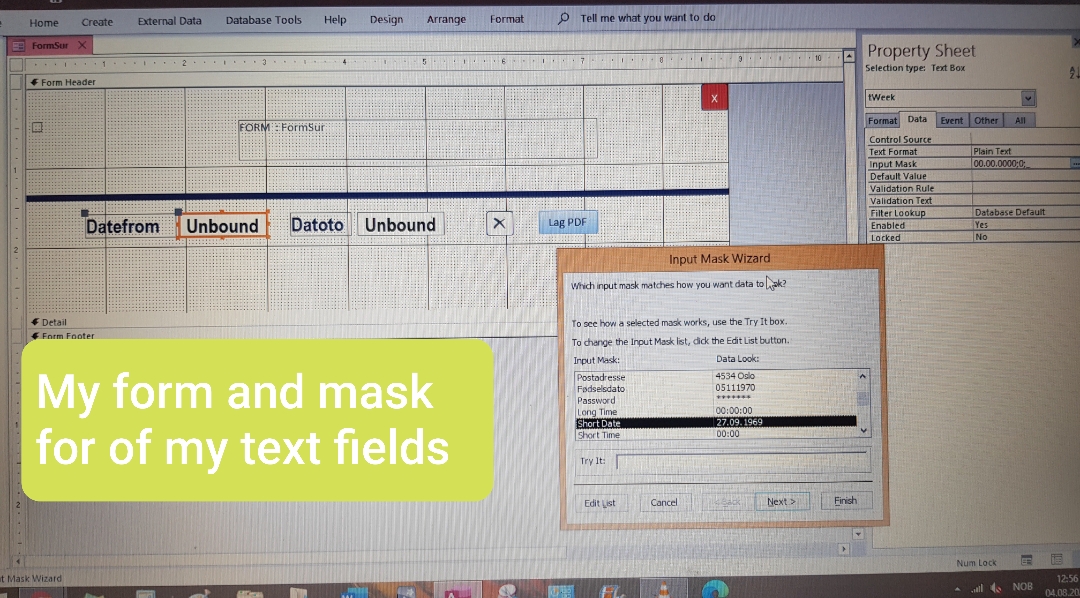

    I am attaching some pictures for you to see how I created my table, form and report, so you can see what can be the problem.
    My textfields where I type the dates are formated  as shortdate with dd/mm/yyyy mask.
    In my Report the field that I want to filter was named dia , which I changed to DateField, assuming that is the one that you put in your code.
    After I got the error, I also changed your code  to see if that was the problem, but did not work either, and gave me the same 3075 runtime error
    DoCmd.OpenReport ReportName:="RepSur", View:=acViewReport, _
            WhereCondition:="[DateField] Between #" & Format(Me.DateFrom, "dd/mm/yyyy") & _
            "# And #" & Format(Me.DateTo, "dd/mm/yyyy") &"#"
    Please tell what is what I am doing wrong.

    You have to replace DateField with the actual name of your field: dia. Try this:
            WhereCondition:="[dia] Between #" & Format(Me.DateFrom, "mm/dd/yyyy") & _
            "# And #" & Format(Me.DateTo, "mm/dd/yyyy") &"#"
