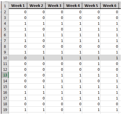

I have a spreadsheet that I'm trying to figure out a formula for, but I'm stuck.  My data needs to be calculated across rows.  I'm trying to calculate the maxium consecutive times the number 1 comes up on each row.  The catch is that the count needs to restart at 0 anytime a 0 is encountered in the row.  The columns all represent weeks of the year, so there will be 52 columns by the end of the year to tabulate.  The original spreadsheet actually has text, but I thought it might be easier to use a formula that had number values, so I had this spreadsheet replace the original text with a "0" for the false condition and a "1" for the true condition.  That leaves me with a spreadsheet that looks like this:
So line 2 and 3 should obviously return values of 0 and lines 4 and 6 should return values of 6.  In line 5, the count has to start over when the 0's are encountered, so that line should return a value of 3.  Line 7 should return a value of 4.  Line 10 is highlighted because it's the one I've been experimenting with the most right now and should return a value of 5.  Line 11 can return a value of either 1 or 0 since the maximum number of consecutive 1's is 1, but the last value is 0, resetting the count.

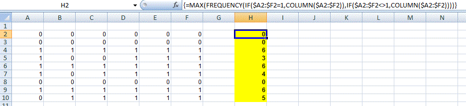

Answer
Amit Tandon
Refer below image:
Enter below formula as an array formula (CTRL+SHIFT+ENTER) in cell H2 & copy down:
=MAX(FREQUENCY(IF($A2:$F2=1,COLUMN($A2:$F2)),IF($A2:$F2<>1,COLUMN($A2:$F2))))
Just update the range per your requirement.
Regards,
Amit Tandon
www.globaliconnect.com

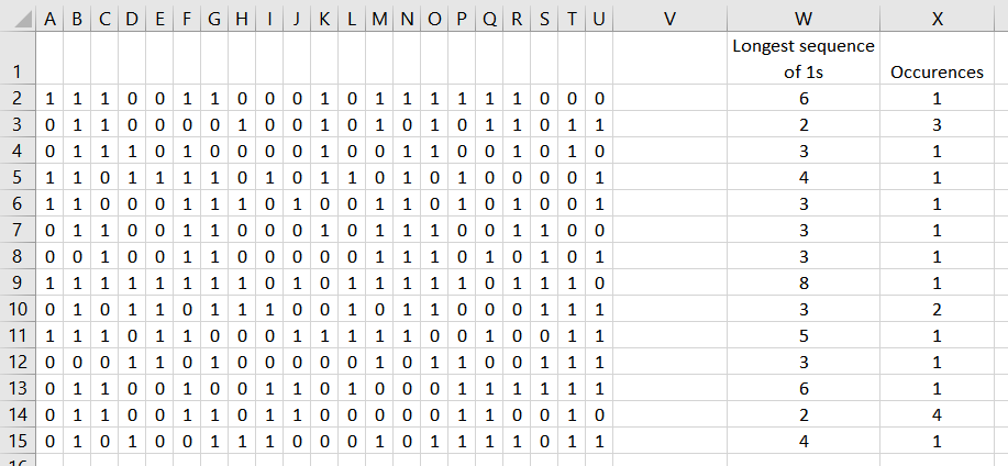

  1. Andreas Killer 144K Reputation points Volunteer Moderator
    2020-09-17T07:28:37+00:00
    W2:  {=MAX(FREQUENCY(IF($A2:$U2=1,COLUMN($A2:$U2)),IF($A2:$U2<>1,COLUMN($A2:$U2))))}
    X2:  =IFERROR((LEN(TEXTJOIN("",1,A2:U2))-LEN(SUBSTITUTE(TEXTJOIN("",1,A2:U2),REPT("1",W2),"")))/LEN(REPT("1",W2)),0)

    2020-09-17T18:17:53+00:00
    Thank you very much! This solved my issue:)
