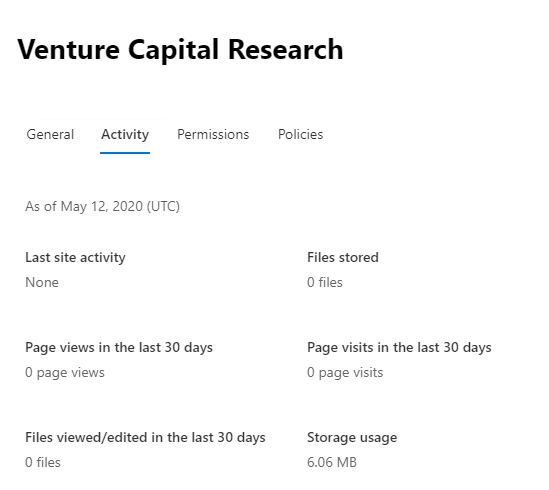

Hello.
I have a question about Last site activity, which can be seen from new SharePoint Online admin centre.
In which cases will it have value None or empty value in site activity reports?
Thank you.

    2020-05-12T10:24:43+00:00
    Yes, it is not consistent with mine.
    In my case site was created on 29.05.2017. There are 15 stored files.

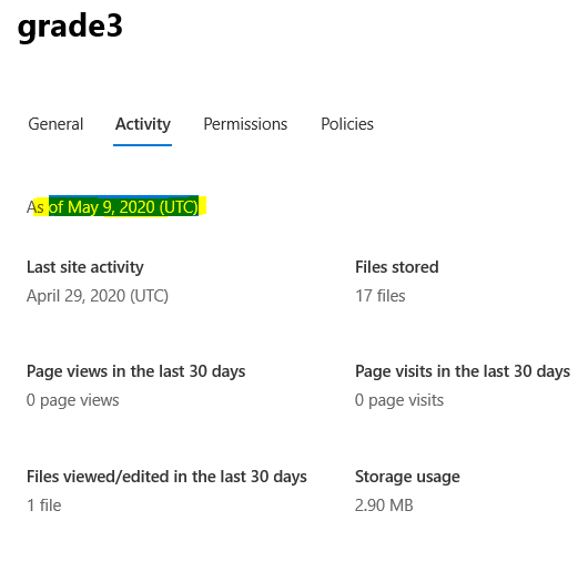

    2020-05-12T09:53:41+00:00
    Hi RolandsStrakis,
    Thank you for your message in this forum.
    According to your description, it seems that you want to know in which cases will it have value None or empty value in site activity reports.
    If so, generally, it will show File stored number under Last site activity, the data update time may be in weekly units. And it seems that the last data update from server is May 9, 2020. As shown below:
    You can also check the date on your side and according to the screenshot you provided, you will also find the date is May 9, 2020.
    So may I know if you created this site after May 9, 2020 or you have not stored any files in this site before May 9, 2020? If you have not stored any files in this site before May 9, 2020, it will not be detected and will not show any activity. And if you created this site after May 9, 2020, you may need to wait for the next time server to pull data.
    If the scenario above is not consistent with yours, may I know when you created this site and if you stored any files before? You can also check if the other old sites to check if you can find any activity.
