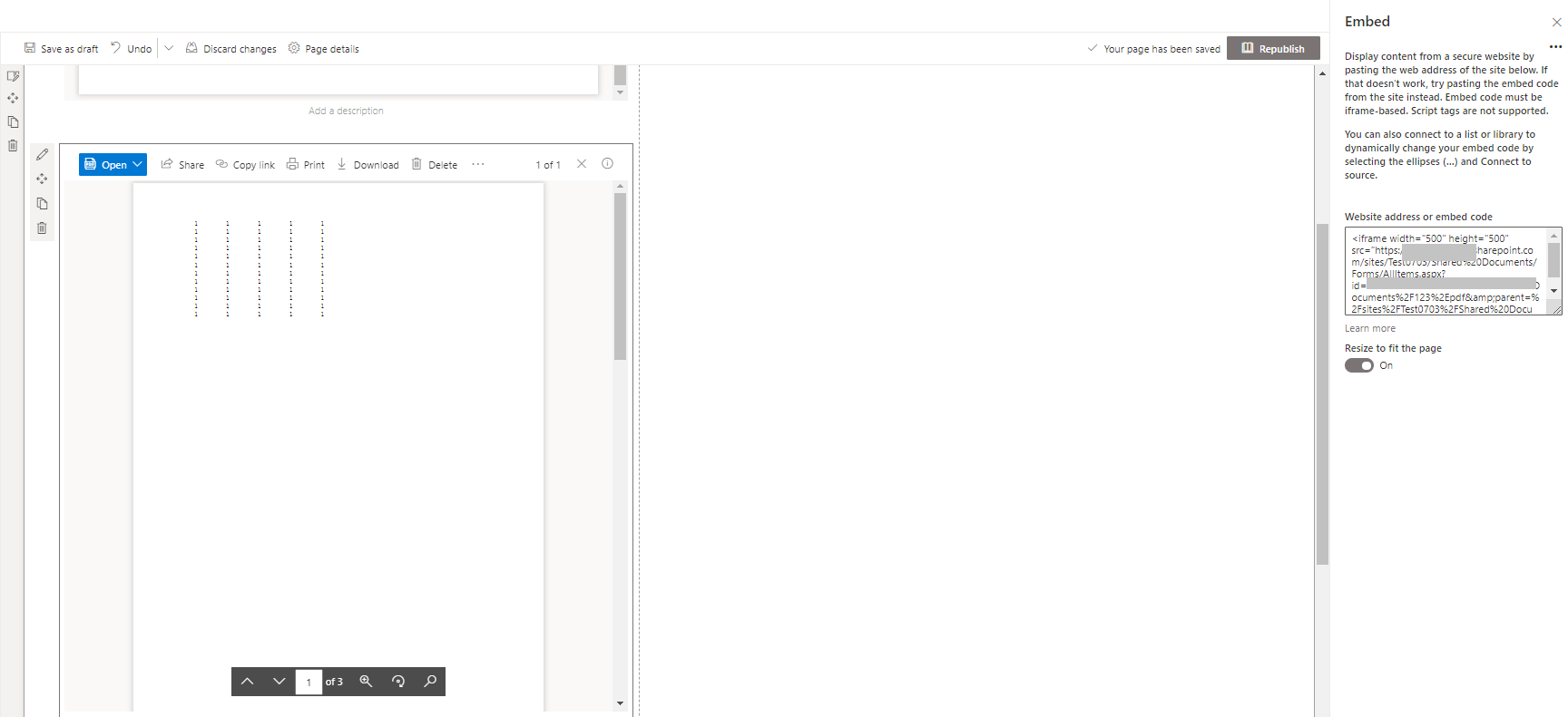

At meantime, here is a workaround I think you can give a shot, which you can use embed code to embed PDF document with Embed webpart with below code:
<iframe width="500" height="500" src="Your PDF file link here "></iframe>
You can change the width and height number to adjust the size to display PDF file. And paste your SharePoint PDF file link into “Your PDF file link here” section.
The output in the embed webpart will look like below:
