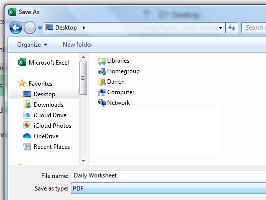

I am looking for a VBA code to open the SAVE AS dialogue box with the suggested file type of "PDF".
I will then assign this macro to a rectangle shape that will serve as a button called "SAVE AS PDF" which the user can click to open the SAVE AS dialog box.
(I am only wanting to save the current worksheet to PDF, not the whole workbook).

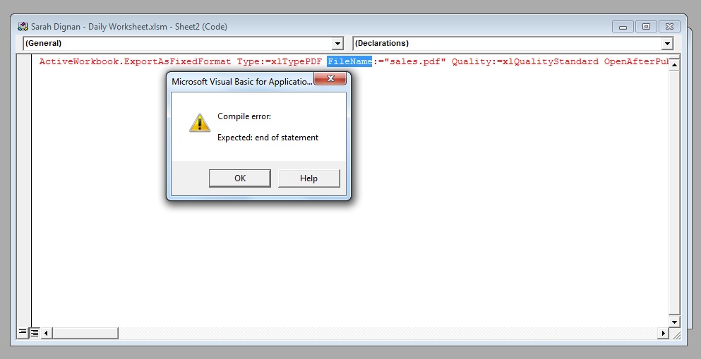

    Hi -
    Please try to add a comma between arguments, for example:
    ActiveWorkbook.ExportAsFixedFormat Type:=xlTypePDF, FileName:="sales.pdf", Quality:=xlQualityStandard, OpenAfterPublish:=True
    Note that this will not open the dialog but will save the file directly according to the arguments.
    Does this help your question? If yes, would you mark it as resolved and give a rating? Otherwise please let me know how I can further help you.
    Thank you!

    2020-05-28T13:07:45+00:00
    Hi Elvissey,
    Thank you so much for the advice. However, I am unable to make it work....
