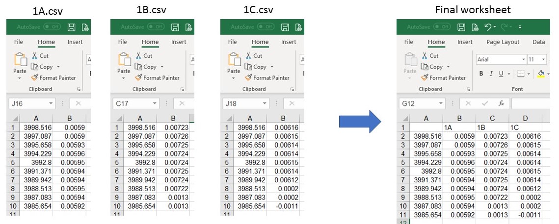

I am totally new to using VBA in Excel and need your help. Thanks in advance!
I have a folder with multiple .csv files which I need to merge into one excel worksheet.
The file details are as follows:
  1. Each file contains two columns of data, the first column is identical in all .csv files. I only need the data from the second columns.
  2. all data should be in one data sheet.
  3. above each column of data (corresponding to second columns in starting .csv files) should be placed the file name from which that data originates.
  4. all starting .csv files are in one folder
Here is the illustration what I expect to achieve:
I found a macros on this website (see below) which almost does what I want, except for putting the names of the starting files in the row 1. What do I need to add it that it also records the file names in the column? Also, when there are multiple files in the folder, which order does the VBA follow in picking .csv files: is it based on the file name or the data it has been created? Huge thanks in advance!

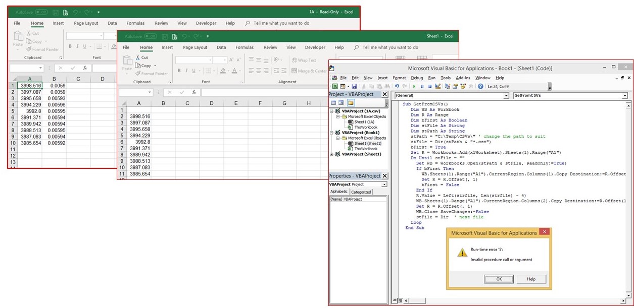

    2020-02-11T07:50:10+00:00
    Hi Hans,
    Thanks for very quick answer! Unfortunately, the new script does not work! After I initiate it with F5, it produces Run-time error 5 after opening first .csv file and producing the first column with data. What is wrong there?

    My apologies, my code had strFile twice where it should have been stFile.
