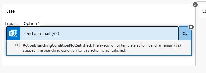

2- now I did a flow as below with Switch condition
all the flow action are pass, but I keep getting the message below for the switch cases (I did OneDrive also for test, but it keep saying "skipped"), so it might I put something wrong in (Equals)? Option 1 is one of the list column choice selection.
What did I miss here?, Thanks for your help.

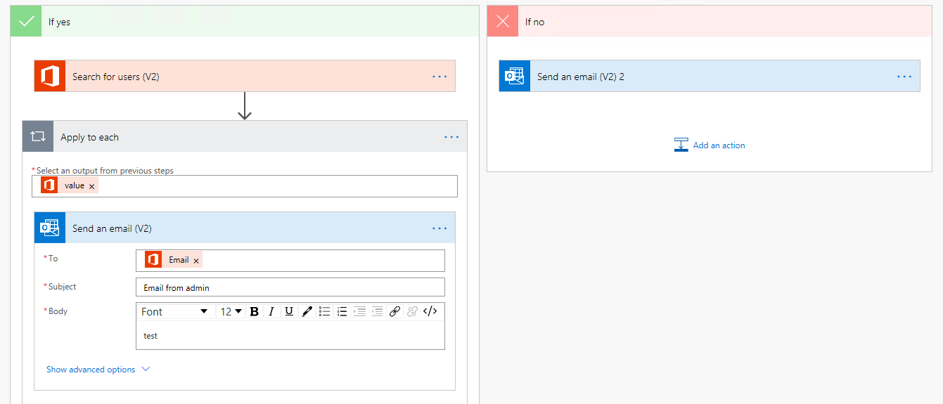

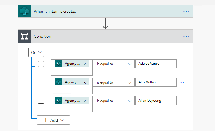

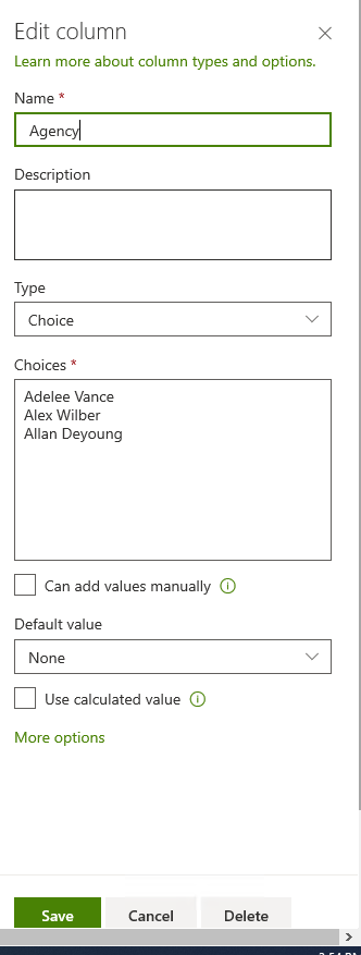

    Dear Ihab,
    Sorry for the delayed reply.
    After multiple tests, I think that the reason may be that the email action can't get the email addresses of the values you select from the Choice column as the Choice column isn't a people picker column.
    You may need to add the Search for users (V2) action to get the email addresses from the choice values to generate the email action.
    I don't use the Switch action in the flow. I use the Condition action in the following flow for your reference.

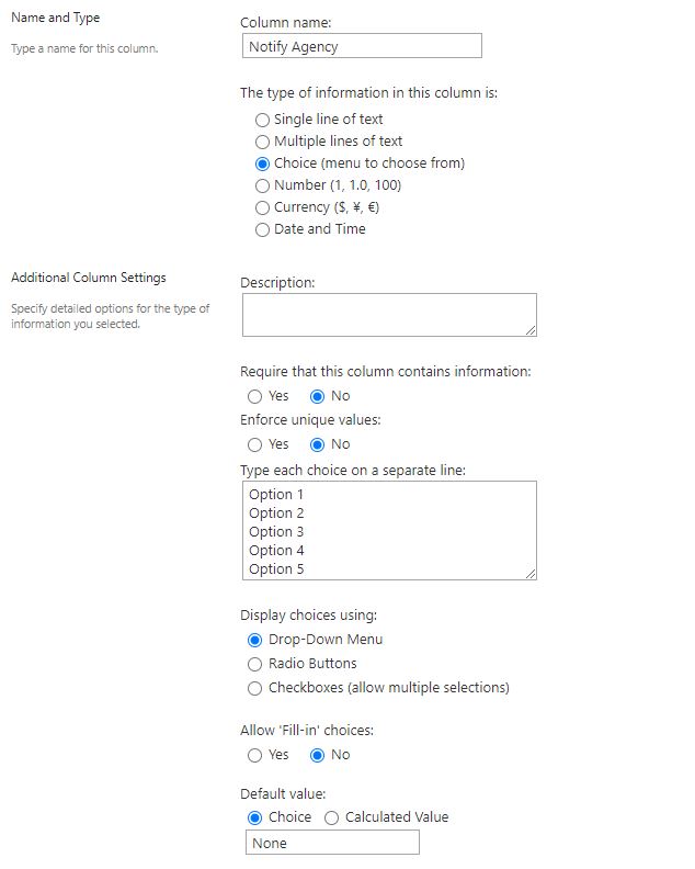

    Hi Cliff,
    Thank you for the response, I attached the agency Column setting in the list, so there is multi options for the user to choose from the drop-down agency, if option 1 has been selected, then the flow will sent email to agency 1, if option 4 has been selected, then the flow will sent email to agency 4, .. etc.
    Thanks.
