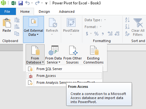

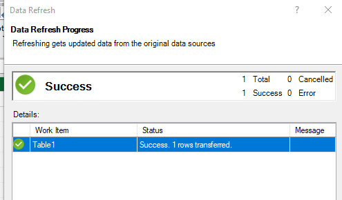

    As we are not sure how you connect to Access Database in Sharepoint online. If you can't use the method in Excel normally, from our side, you can link your data to SharePoint list first and then  save the Access database in the local environment, then open Excel>Data>Go to PowerPivot window, then select get external data from Access:
    Then browser your Access file location and complete the process according to the prompted message.
    After completed, you can refresh your data as normal:
    Please have a try and share the result with us.

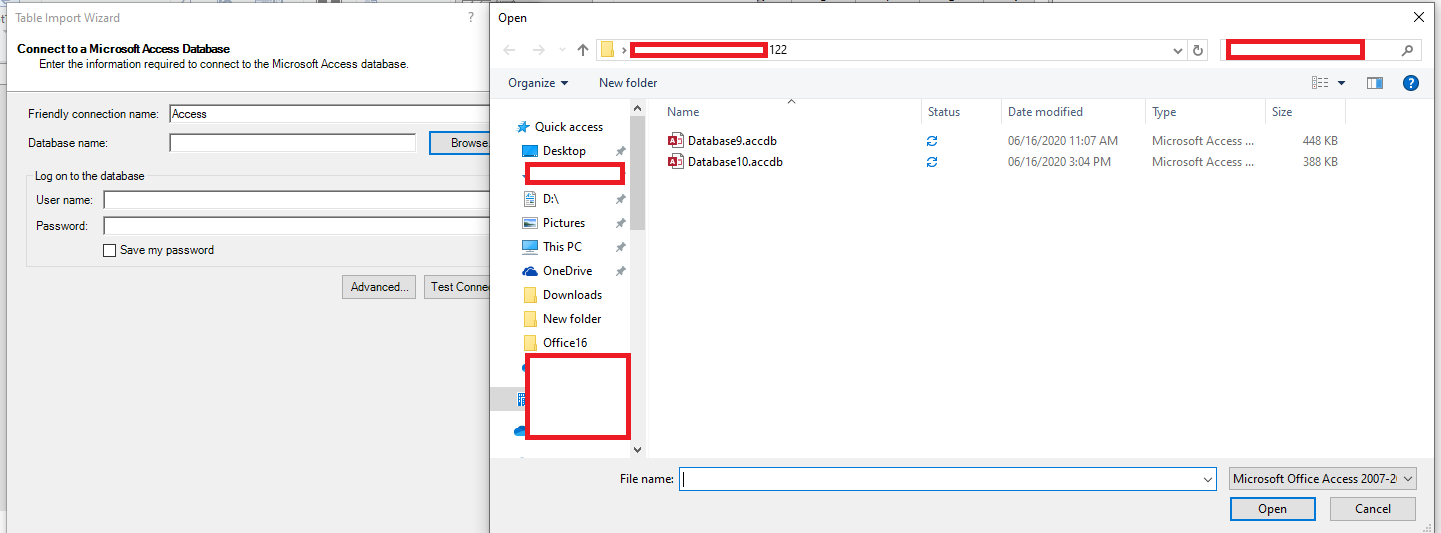

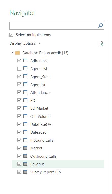

    Iwas thinking at first to put all my database in SharePoint, but when I see the time I need to load all the data there and how it is not practicle for me to amend data inside. I resign from this idea. So I think Access Database was the best option.
    I think I did exactly how you show above, you just have another version than me.
    And then select all the database I have:

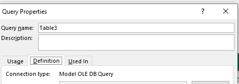

    Besides, according to your method, we are sorry that we got a Model OLE DB Query instead of Microsoft Access Database of Connection type:
    Therefore, you can follow my method to check if you can update the data edited by other users, and please post back more detail about your method which can be helpful to help us reproduce your issue from our side.

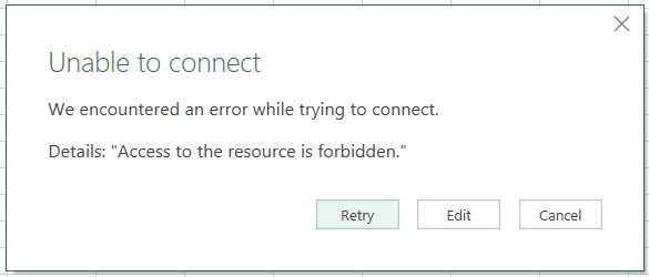

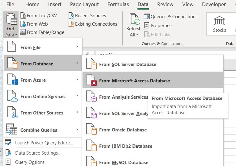

    Hi Higgins,
    When I try your way, I got this error once I try to connect with my Access Database:
    It is possible that Sharepoint do not allow me to read data from an Excel when I try to connect directly through the SP Path?
    Thank you again for your support, Kev.

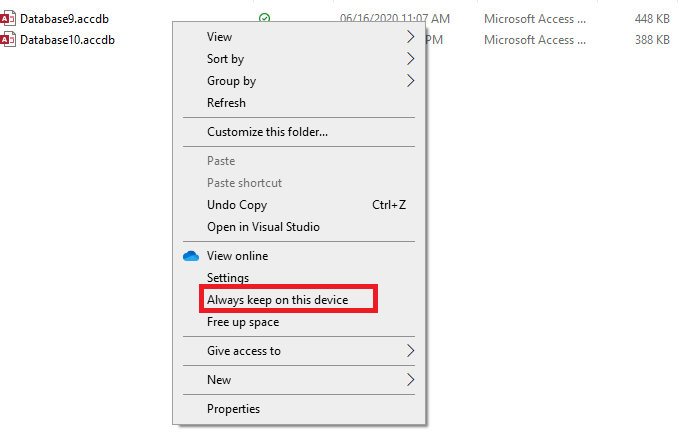

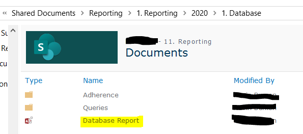

    From your situation, we would like to inform you that you can connect your Access database from the OneNote sync folder instead of the SharePoint path.
    Once you upload your Access file in SharePoint online, click Sync button on the top ribbon to open your OneDrive sync folder, and then find your Access file in the OneDrive sync folder and select Always keep on this device:
    Then you can go to Excel>Data>Data tools>Go to the PowerPivot window, and then you can follow the steps in my previous reply to get your Access data:
