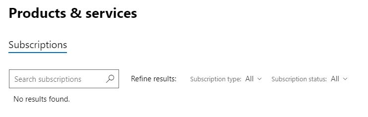

    If you read nothing else, please read this bit:THERE IS NO SUBSCRIPTION TO DELETE ON THE PRODUCTS and SERVICES PAGE!
     I appreciate that you may not convinced, so here is a screenshot:

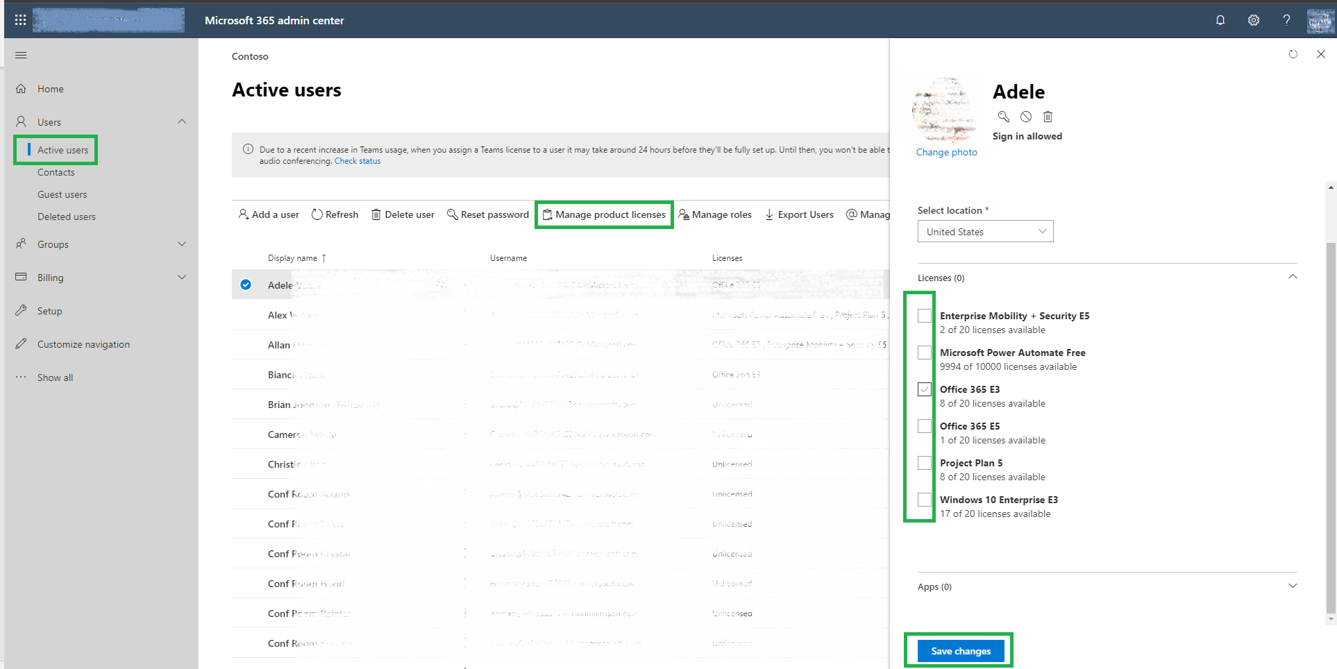

    The existing SharePoint Online (Plan 1) license is odd as there doesn't have any subscriptions in the Products & Services page in Office 365 admin center. I would like to suggest you check whether there have subscriptions assigned to the users who have the SharePoint Online (Plan 1) license. If so, de-select the assigned license and check the results.
    If the issue persists, we would like to suggest you raise a ticket from the Office 365 admin center (if it's possible) for further investigation. We are willing to help you, but we indeed have limit resources regarding to the back-end issue. The related support will help you more efficiently regarding this issue. We appreciate your understanding and patience.
