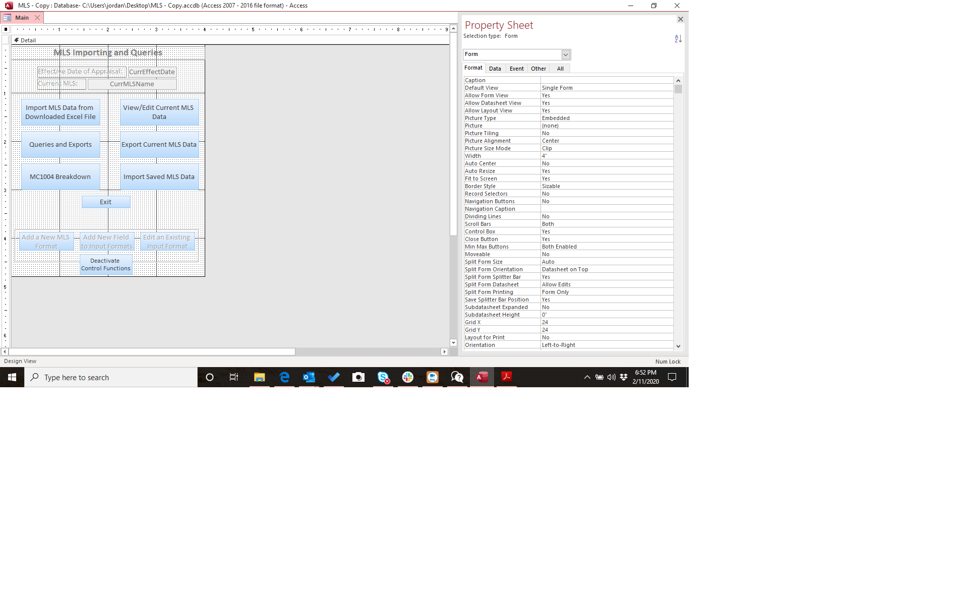

I recently inherited this Access DB and the original Developer is not available.  I am trying to get it to display all the programming menu's, so I can start to reverse engineer the code.  I can <Right Click-->Design> on "Main", but that's about it.  I can not get the standard Access menu's to display so I can begin looking at the code.
Can someone provide me guidance?  thank you

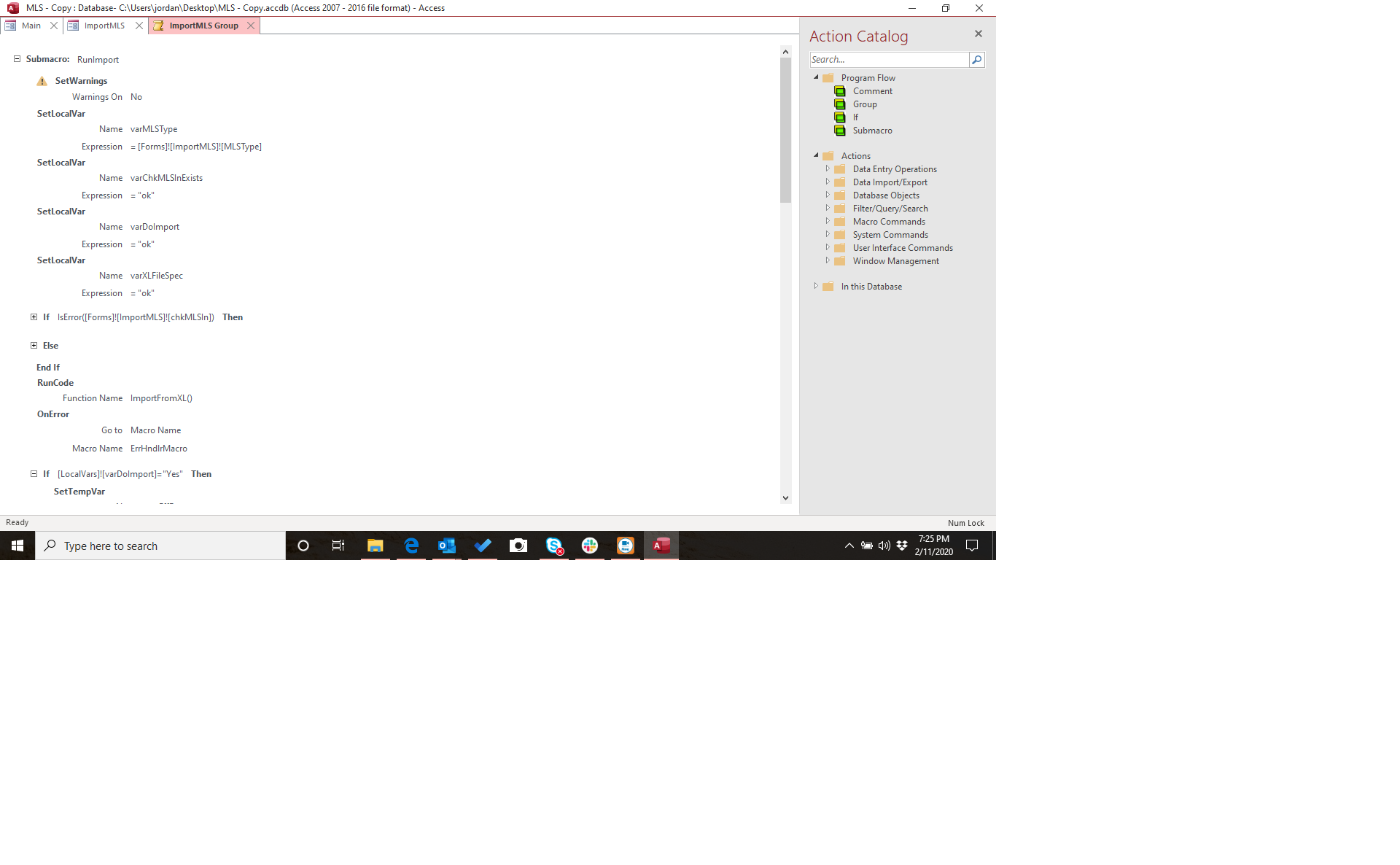

    Thank you for that info.  I have been able to get into the Macro screen and I checked out the VBE screen too.  I found the code in both to be very cryptic, and I can't seem to be able to map it back to Database tables.  I can't even access the database tables themselves.
    I was hoping there was a way to get into the navigation of the menu's, like below, but I have tried clicking on Design View and it does not show the menu structure at all.

    I'm not sure what you are expecting. If you are referring to the ribbon, that is an internal programming and not accessible. If you are referring to buttons like New Contact, You need to do what I said, Open the form in Design mode, select the New Contact button control and then look in the On Click event.
    Again, most code is event driven. So you need to look in the Events. I'm not clear what menu structure you are trying to look at.
    The import macro you show sets the variables and then runs a VBA module to import an Excel sheet.

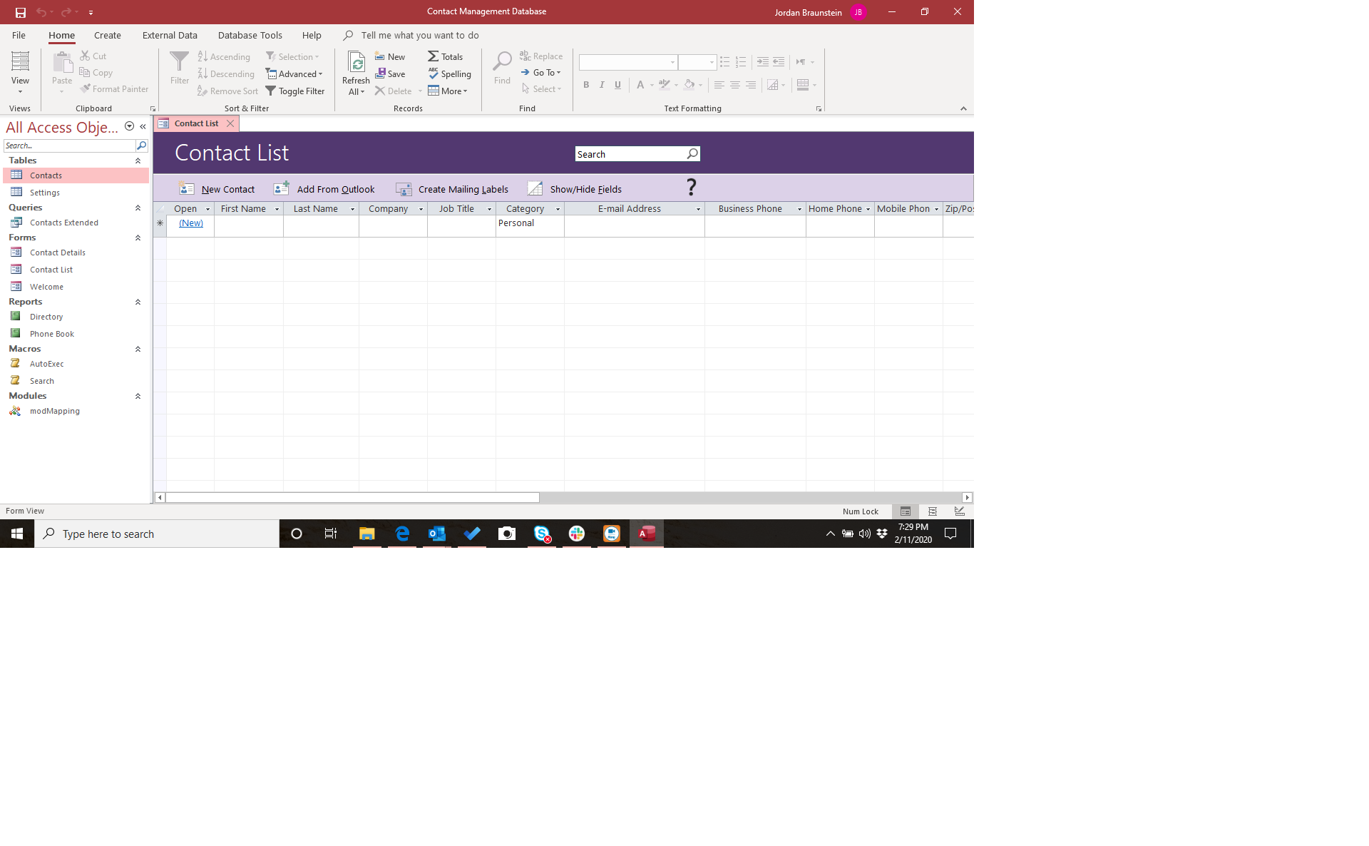

    This screenshot indicates this was started from the Contacts template.
