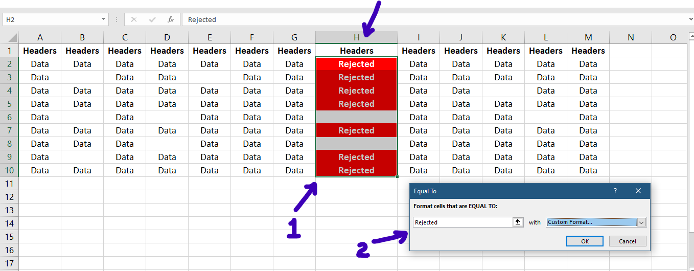

Rule 1  For the cells in column H that**say ‘Rejected’
1- Select the range of cells in column H
2- Then Format cells Equal to "Rejected"
3- Format RED

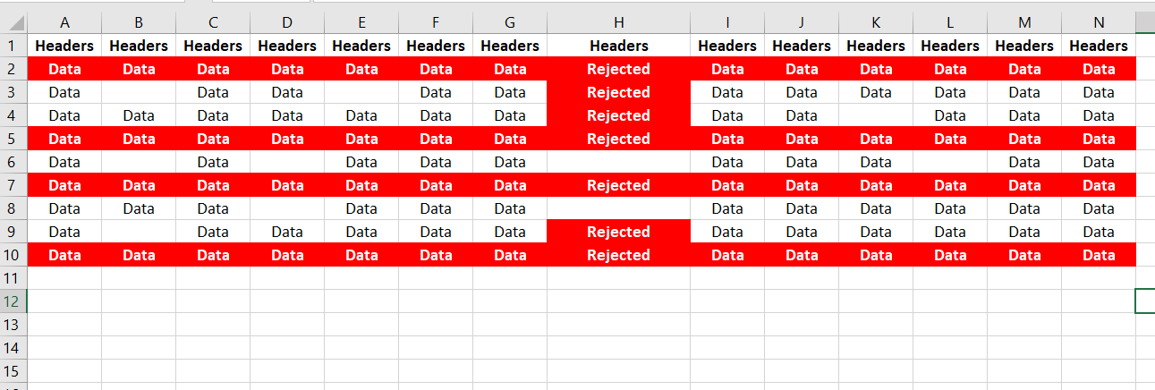

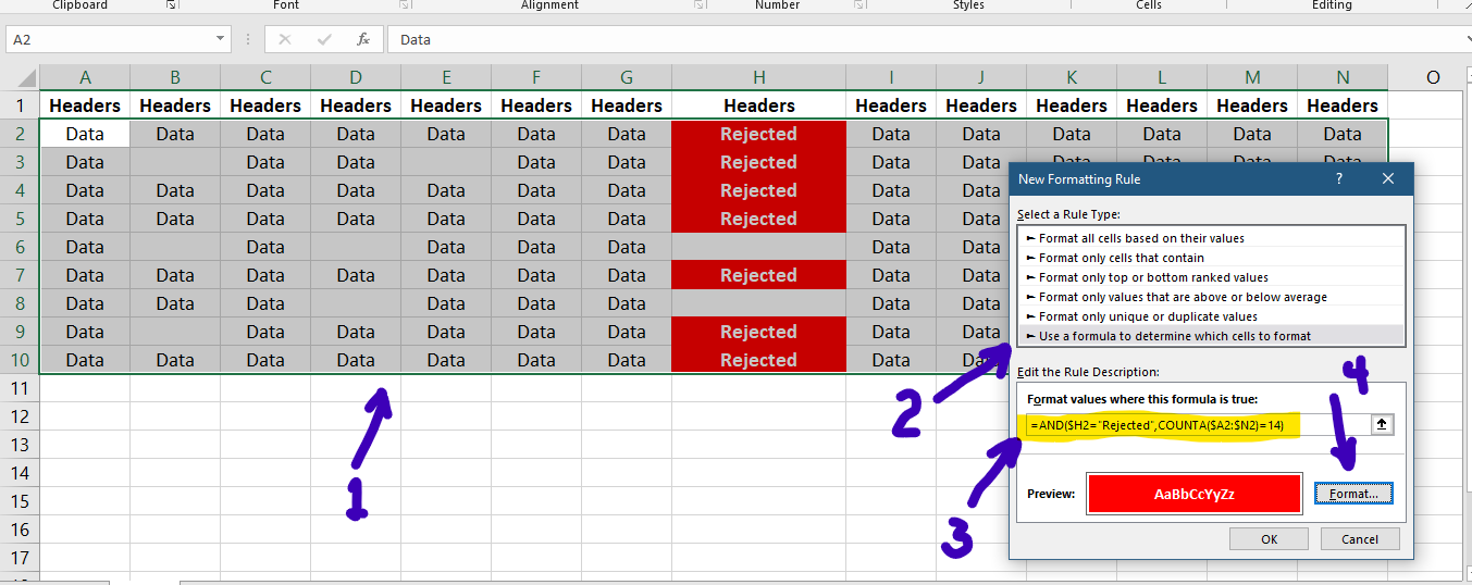

Rule 2Make entire row Red if the cell in column H says ‘Rejected’ but only if there are no blank cells in that row.
1- Select this time the entire data range
2- Go to CF \ New rule\ Use formula to determine...  =AND($H2="Rejected",COUNTA($A2:$N2)=14)
RESULTS so far

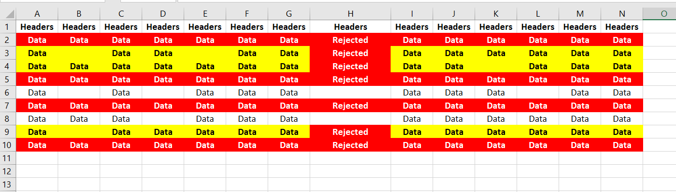

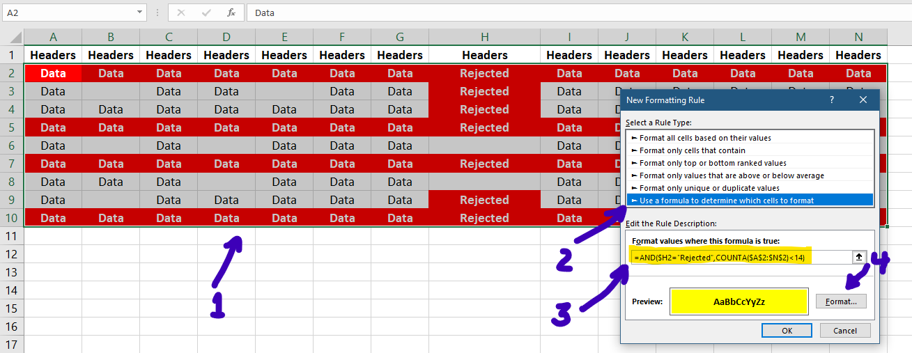

Rule 3 "... If there are blanks in that row I would like the cells in that row to change toyellow."
Similar procedure to Rule 2 but the formula to use this time is
=AND($H2="Rejected",COUNTA($A2:$N2)<14)

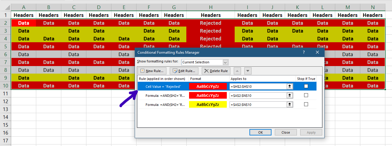

IMPORTANT
Make sure in the CF rules manager the rules were in the order as in the picture below
FINAL RESULT
