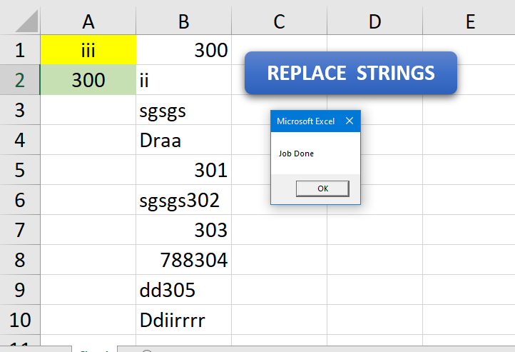

    Hi
    Please, try this macro
    Note: This is a dynamic solution
    Let's say the strings to be replaced are in column "B" Then
    In cell A1, type the search criteria (ex. "iii")  in Yellow
    In cell A2, type the starting number  (300)  in Green
    and run the macro with the help of a button
    Change the ranges according to your real scenario.
    AFTER
    BEFORE
    Here is the code
    Sub ReplaceStringwithNumbers()
    Dim myRange As Range, str As Range
    Dim myString As Variant, myNumber As Long
    With ActiveSheet
            myString = Range("A1").Value   ''' the search string
            myNumber = Range("A2").Value  ''' the starting number to replace
            Set myRange = Range(Cells(1, "B"), Cells(Rows.Count, "B").End(xlUp))  ''' the searching column range
            For Each str In myRange
                If InStr(1, str, myString, vbTextCompare) > 0 Then
                        str.Value = Replace(str.Value, myString, myNumber)
                        myNumber = myNumber + 1  '' number increment
               End If
            Next str
    End With
    MsgBox "Job Done"
    End Sub
    I hope this helps you and solve your problem
    Regards
    Jeovany
