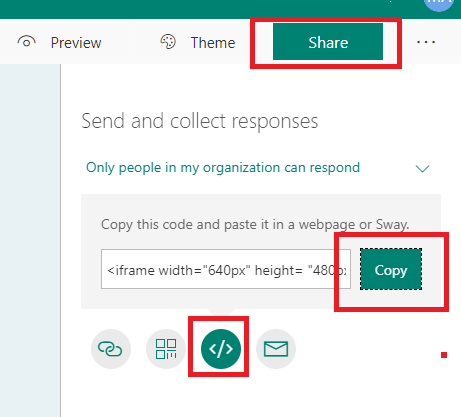

    1. Create a form and then go Share > Embed > copy.

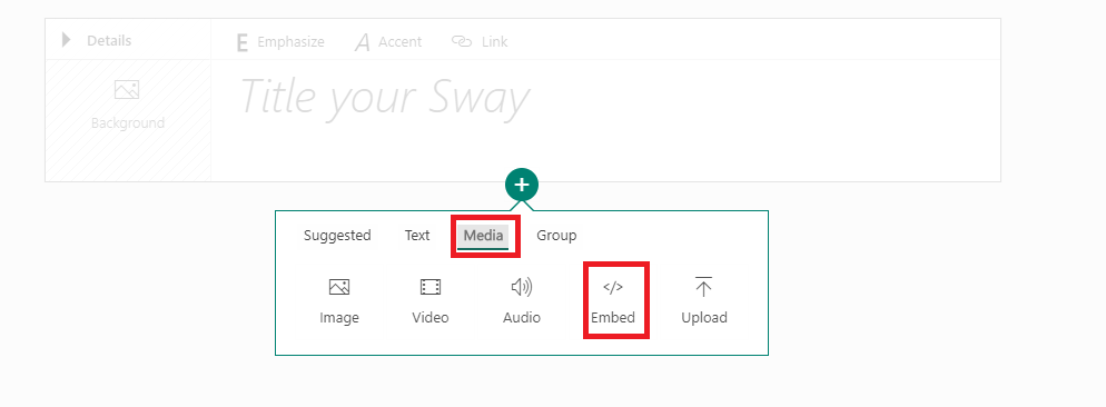

    1. Create a new sway, add a new section, go Media > Embed.
    1. Paste the code into this part.
