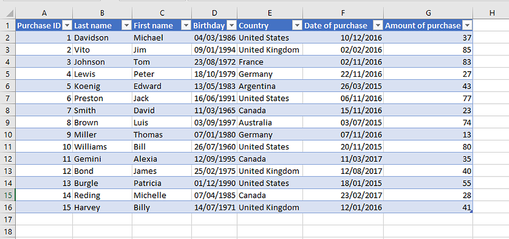

    If your Table is an Excel Table like the one in the sample picture below
    Then try this code
