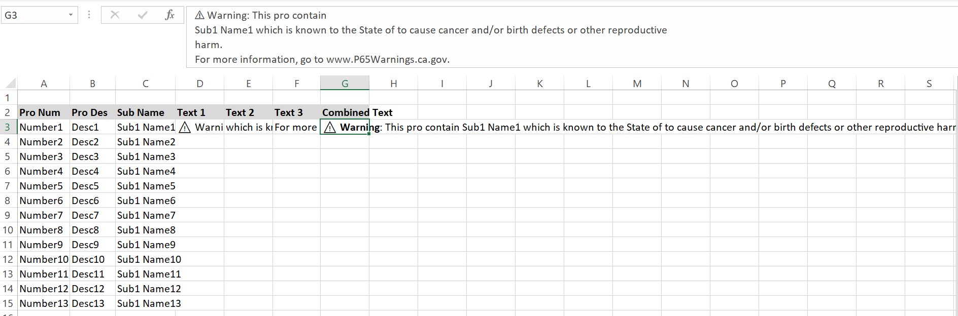

I am trying to achieve the following. To combine D3, B3, E3 and F3. But need to have a line break before F3.
For better understanding see this example PDF link

    Use the formula
    =D3&CHAR(10)&B3&CHAR(10)&E3&CHAR(10)&F3
    This can be filled down.
    Make sure that Wrap Text has been turned on for the cell(s) with the formula.

    Hi
    Try the formula  =TEXTJOIN(CHAR(10),TRUE,D3,B3,E3,F3)
    Adapt the ranges in the formula according to your scenario
    I hope this helps you and gives a solution to your problem
    Do let me know if you need more help
    Regards
    Jeovany
    2021-04-20T17:54:33+00:00
    Thank you very much.
    I did try CHAR10 but with out parenthesis so it did not work for me initially.
    Final version =D3&CHAR(10)&B3&" "&E3&CHAR(10)&F3
    2021-04-20T17:54:51+00:00
