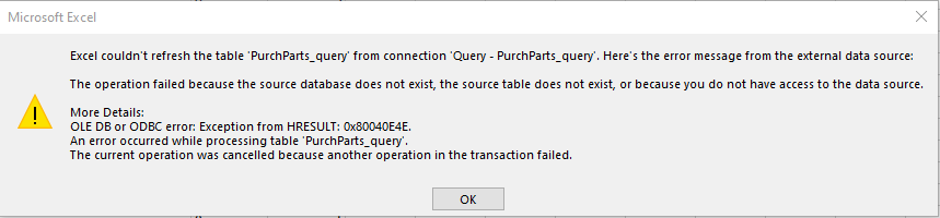

After cancelling the operation by hitting ESC, I got this error:
which is weird, since the data source is a table in the same workbook. Table's name is ok.

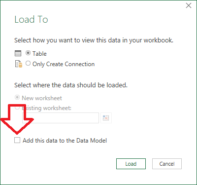

    Right-Click the "kanban" query \ choose "Load To..." \ Uncheck "Add to Data Model" \ Load \ Try Again
    Maybe do the same with your other query.

    Thanks Andrea. However, my kanban query is not set to load to data model . The other one is. When I uncheck that box, and check again it loads after a while. But it doesn't solve the problem because whenever I try to refresh it , the problem remains the same and the query never finishes loading again.

    I know about that issue, the problem is the data model, I've had the same problem in the past.
    The only stable way I found is to uncheck the data model option.
    Andreas.
