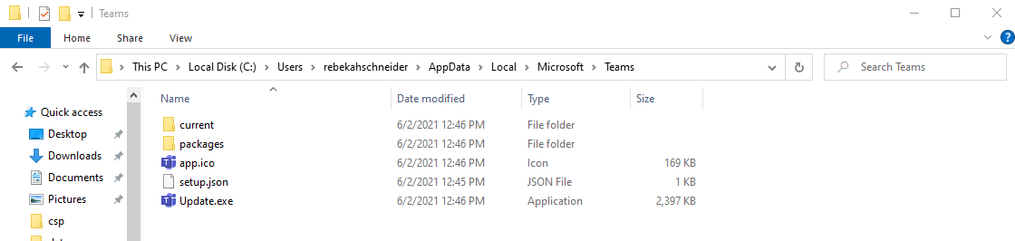

    Regarding to the error, there is a chance that the Teams folder is not created successfully. To check it, please navigate to the folder location C:\Users<username>\AppData\Local\Microsoft and check if there is a folder named Teams. If not, please create it manually and then reopen Teams to see the result.

    I checked the Microsoft folder and there is a Teams folder that was created after the re-installation yesterday. Image
    I have also completed the cleanup and attempted to open Teams again but still got this error twice.
    And I'm sorry if this wasn't clear before, but I am unable to open the Teams application because of this error. When I try to open Teams I get this error twice and then nothing opens. I also get this error twice if I uninstall or install Teams but in these cases Teams will get uninstalled or installed.
