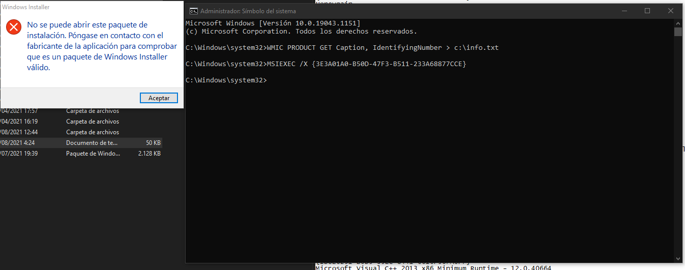

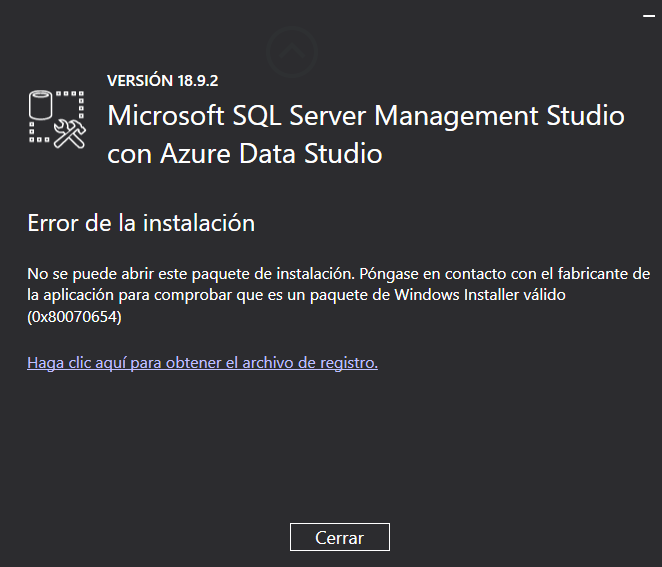

Hey everyone,
so, I tried installing both SQL Server 2019 and SSMS 18, and I got some error during installation. SQL Server 2019 setup went static for about an hour while stopping almost every process and I had to restart (It seems it installed correctly tho, but I only have 1 service related to SQL, SQL Server VSS Writer).
The problem is, when I tried installing SSMS 18, it completely crashed my PC (BSOD something about the kernel), and now I cant even uninstall / repair the program because I get an "Installation error. Can't open installation package, get it touch with the app developer to check if it's a windows installer valid package. ERROR 0x80070654 "
Here's the log and the error:
121972-ssms-setup-esn-20210810093414.log
SQL Server | Other

  4. YufeiShao-msft 7,146 Reputation points
    2021-08-11T07:18:39.36+00:00
    Hi @Sebastián Re ,
    From your screenshot, your installation failed. You can try to turn firewall off and run as administrator when installing SSMS. Make sure that the language of the installation package is consistent with the OS. Of course, you can discard the old installation package and try downloading and installing again in any case.

  5. Sebastián Re 1 Reputation point
    2021-08-11T17:57:10.08+00:00
    Already tried that, with no luck. The installer detects that the program has already been installed on the pc, so it shows the "uninstall" and "repair" options. Both options give the same error as shown above. I need to find a way to FIRST uninstall completely ssms manually, and then try to reinstall it.
