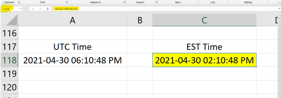

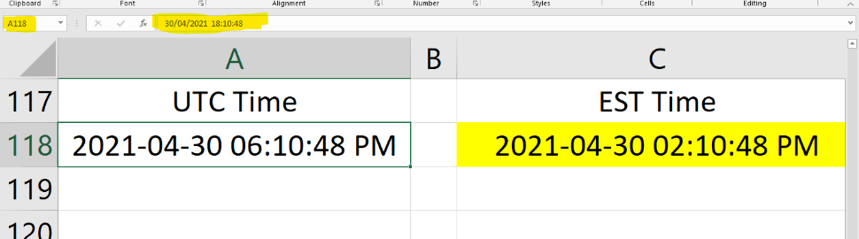

Hi
Try the formula in cell C118=A118-TIME(4,0,0)
Make sure the UTC time value entered in A118 is NOT a TEXT value
It must be a real Excel time value as shown in the picture below
I hope this helps you
Regards
Jeovany
