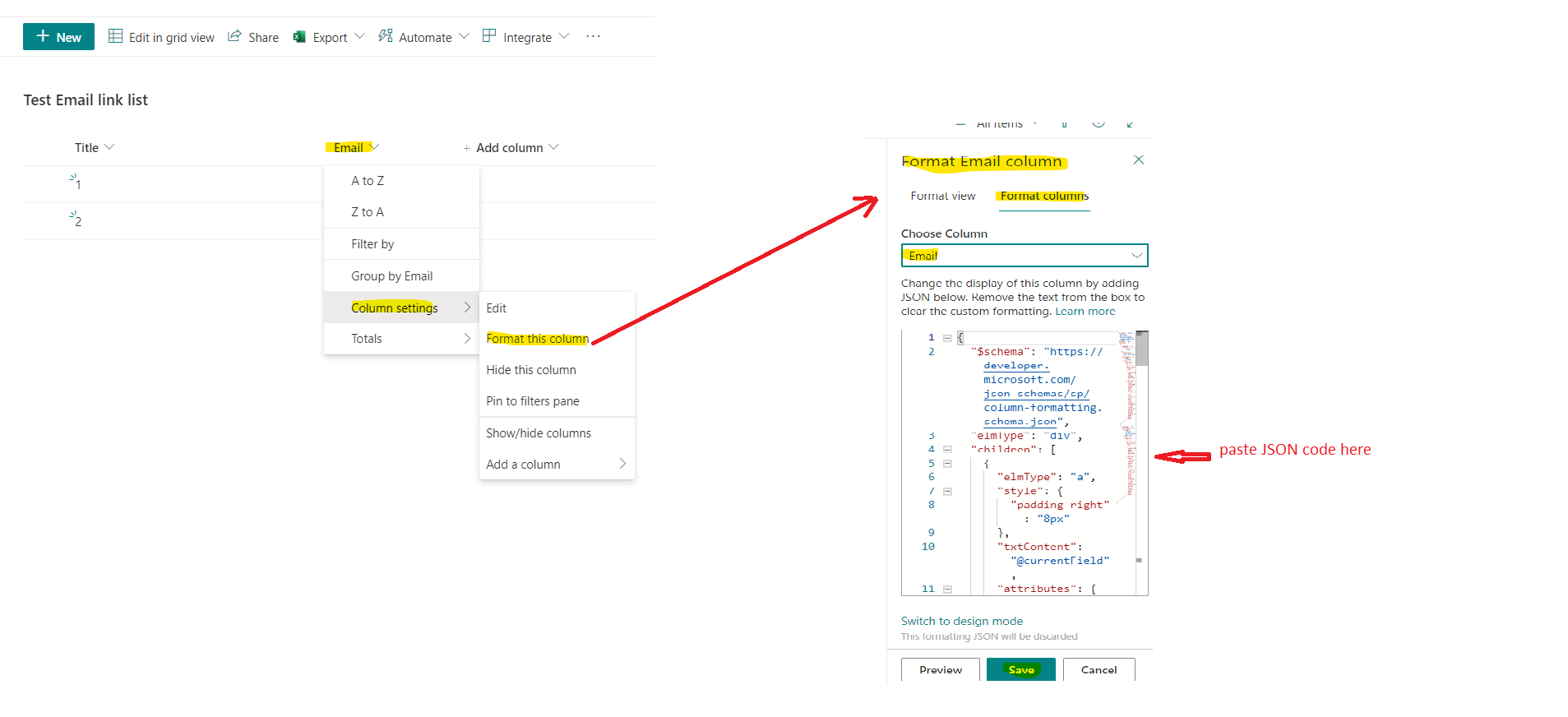

    Hi Beth College,
    As per your description, you need to add column(single line column) or in your Email column use a below JSON code formatting to make a email address as a link in SharePoint Lists . Go to Email column (single line column), right-click on column>Column setting>Format this column> Advance mode> and paste below code there and click "save" to check the result.
    Reference screenshot:

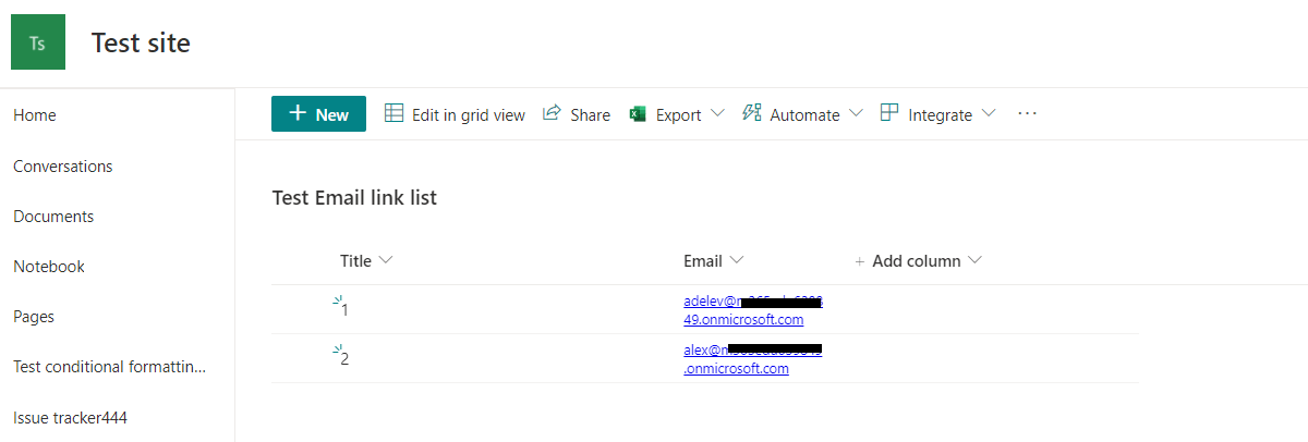

    Result:
