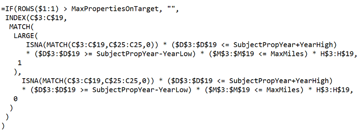

What I'm working with in C26:
=IFERROR(INDEX($C$3:$C$20,MATCH(LARGE(IF(($D$3:$D$20<=(INDEX($D$3:$D$20,MATCH("Subject*",$B$3:$B$20,0))+$P$7))*($D$3:$D$20>=(INDEX($D$3:$D$20,MATCH("Subject*",$B$3:$B$20,0))-$O$7))*($M$3:$M$20<=$P$9),$H$3:$H$20),ROW(1:1)),$H$3:$H$20,0)),"")

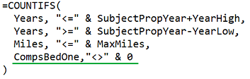

    Re. ...but the 3-bed section isn't working for some reason
    If you got the correct link yesterday you would have seen that I renamed (I mentioned it) MaxPropertiesOnTarget as MaxPropertiesOnTargetOneBed. Reason is: to exclude cells = 0 COUNTIFS must refer to the appropriate range (formula with your named ranges):
    and there's no way to dynamically change CompsBedOne with i.e. CompsBedTwo as you have 3 different reports. So, I duplicated the above formula (changing the appropriate CompsBedXxx range) and named them:
    • MaxPropertiesOnTargetOneBed
    • MaxPropertiesOnTargetTwoBed
    • MaxPropertiesOnTargetThreeBed
    • MaxPropertiesOnTargetStudio

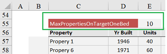

    I (hopefully) fixed your example with the above named formula. At the top of each report you'll see i.e.:
    so you can easily check during your simulations

  1. Lz._ 38,106 Reputation points Volunteer Moderator
    2021-05-28T08:58:34+00:00
    @Ryan2019
    (it's me who merged your 2 = threads). Couple of notes:
    • Ignore "-" is useless. The - is only a representation of 0 when a cell is formatted as accounting
    • Not sure why your Index, Match... did include the Subject Property row (except if I misunderstood), changed to C3:C19
    • Named a few cells for clarity and more importantly to avoid matching n times the same thing
    • In Name Manager: MaxPropertiesOnTarget counts the number of properties meeting the criteria This avoids unecessary calculations hidden with IFERROR(..., "")
    in C26 (pic. as this site currently bugs re. formatting):
    Updated sample available here
    PS: If it was me I would work with Tables (instead of ranges), at least to put clarity in my formulas, not to mention dynamic ranges. You want something that works with previous versions of Excel, fyi Tables exist since Excel 2007. In this article, a few benefits of Tables vs Ranges

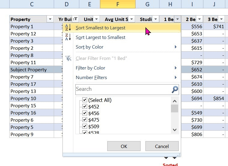

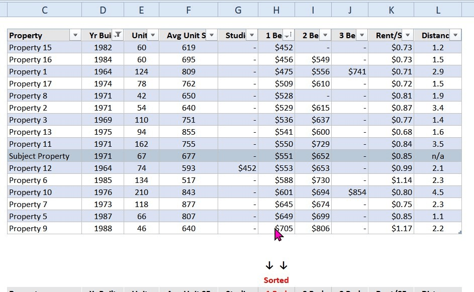

    1. Define data as table
    2. Turn on the "Filter" feature to show the drop down arrows for sort and filter option
    • turn filter on and off in Excel (Ctrl + Shift + L)
    You can clear the filters to apply new conditions.

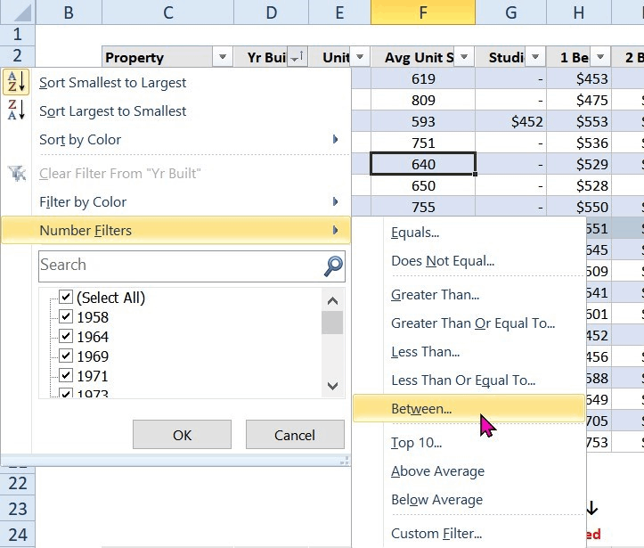

    These 2 videos show you how to do filtering.
    Using this function requires an educated user (if the question is for sheet used by someone else)
    @ Filter: Basic to Advanced                2018 03 01
    https://www.xelplus.com/excel-filter-basic-to-advanced/
    Excel's AutoFilter is a great feature to quickly display the rows in your data table that meet a certain criteria. The remaining rows that don't match your criteria are automatically hidden. Once you have your selection in view, you can edit the entries or copy the filtered list to another location.
    Since there is a lot to filter than meets the eye, I’ve broken it down to two tutorials.
    In the filter basic tutorial you’ll learn the following:
    .  1.  The shortcut key to turn filter on and off in Excel (Ctrl + Shift + L)
    .  2.  How to do approximate matches (filter for words that contain a specific word)
    .  3.  How to filter multiple columns
    .  4.  How to filter for OR conditions using wildcards
    .  5.  How to copy a filtered range to another sheet
    .  6.  How to use formulas (such as subtotal) to sum a filtered range
    .  7.  How to filter for values between 2 dates
    .  8.  How to filter based on color
    .  9.  How to turn your data set into an Excel table (Ctrl +T)
    . 10.    How to add totals to your Excel table
