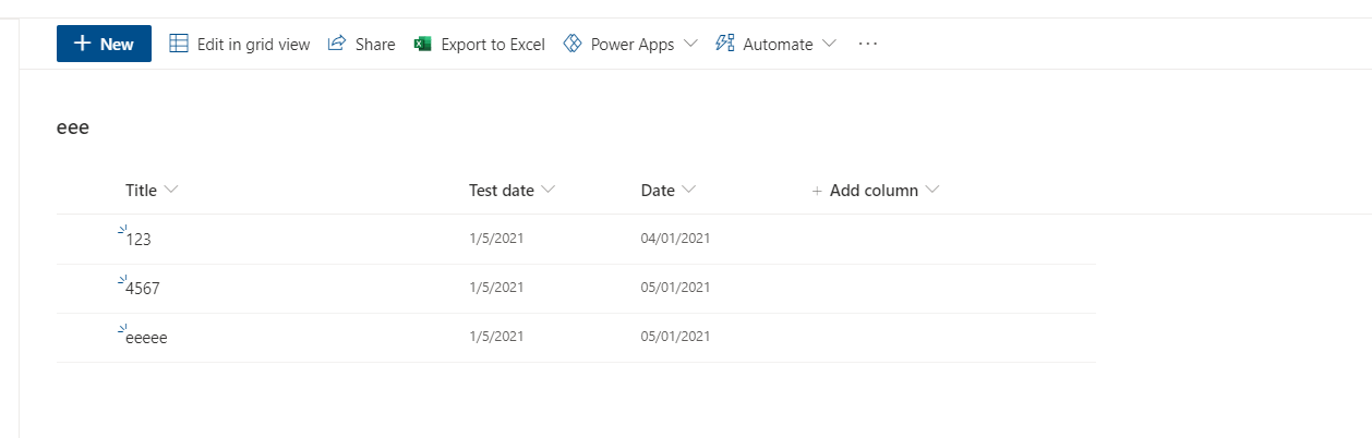

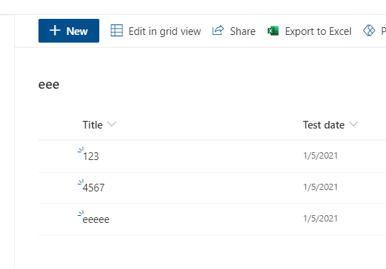

    To change date format on a list to DD-MMM-YY, you can follow the below steps:
    1. Go to your list, where you would like to see the formatted date and time.
    2. Currently, it displays SharePoint default date and time format.
    3.Now, we would like to display date DD-MMM-YY, as shown in the picture given below. We have added a new column to display the format.
    4.To achieve this, we need to add a calculated column and use the sample code given below.
    Meanwhile, please try to double verify Time zone setting from different user side via go to setting> site setting> Regional setting. Also please confirm does issue happen to specific list in SharePoint online or all list.
