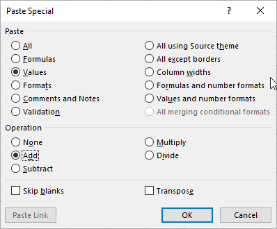

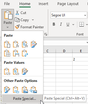

This will work with copy/paste. When pasting, select Paste Special:
Select Values and Add:
This will paste the text values as numeric values.
Kevin

You stated two problems in your original post. The first was exporting to a CSV while keeping leading zeroes. You stated you had a solution for that using a formula. The next problem you stated was "I tried formula =LEFT(A2,LEN(A2)) and it worked until I need to copy and paste values, then it pastes it as Number stored as Text." My solution solves that by converting the text values to numeric values. If you want the leading zeroes then you don't have any problems at this time. If you want the numbers stored as numbers then use my solution for pasting.

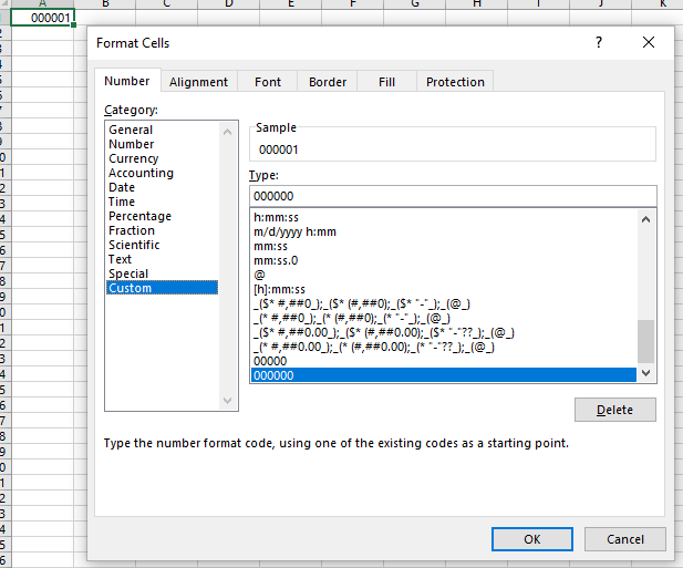

If you want numbers stored as numbers to have leading zeroes on the worksheet then you have to format those cells appropriately. Here is an example of a number with six positions, five of them are leading zeroes:
Kevin
You can also solve the first problem using formatting. When numbers are formatted as illustrated in my previous post, saving the worksheet as a CSV file preserves the formatting.
Kevin
