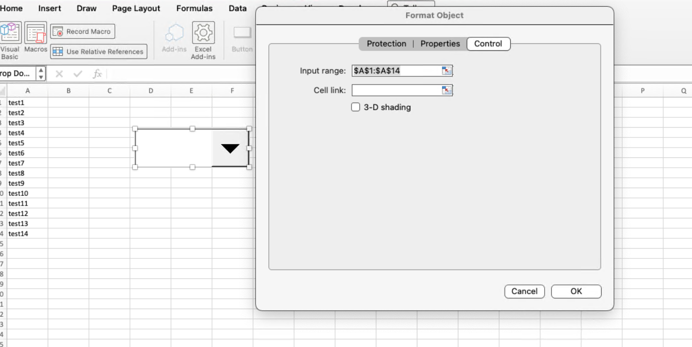

Below is what I created in my windows 10 excel 2016 in that developer ribbon it creates the drop-down box and shows the properties unlike the above when I load the spreadsheet in excel Mac.

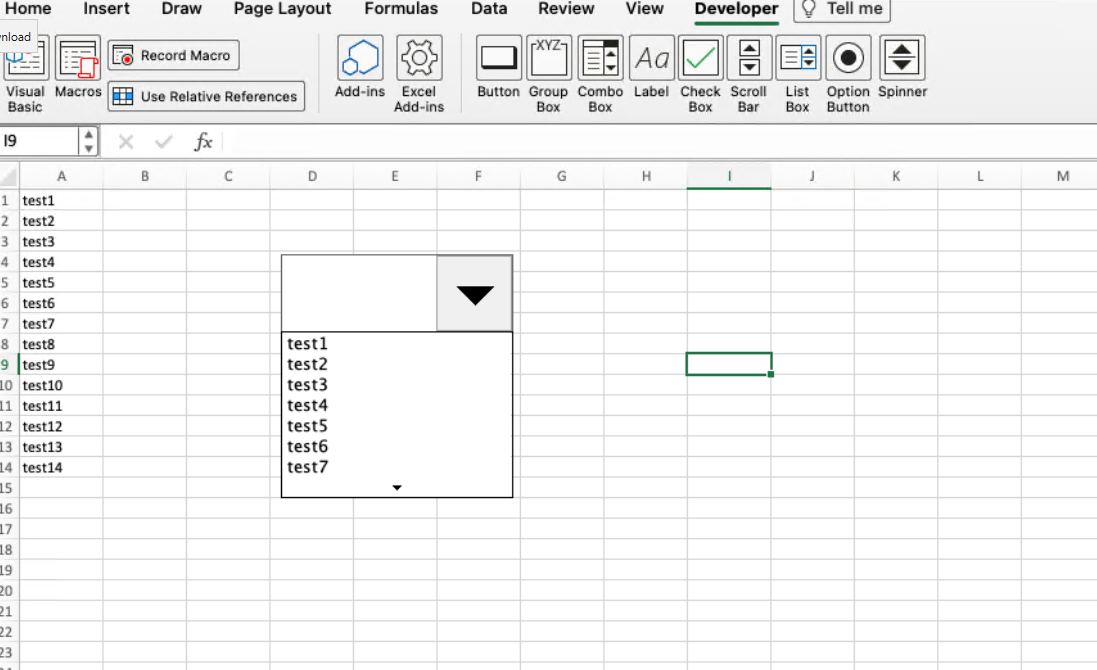

    Dear Mark,
    The drop-down menu is Combo Box in Excel for Mac. You can try it to see the result. If something is misunderstanding, welcome to share your updates at your convenience.

    How did you create the list element? If on your PC you used a Content Control rather than a Legacy Form Field Control. Although Mac Office does now support the use of Content Controls created in a Windows version it does not yet have the UI tools to create or modify them.
    If it is a Legacy Form Field Control it would be a Combo Box rather than a Drop-down List.  Right-click it & select Format Control.

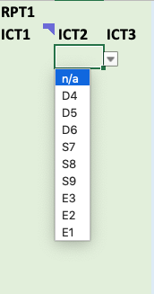

    It's hard to tell from a screen shot but it actually appears to be a Data Validation List. If that's the case, select the cell then either go to Data> Validation in the main menu or click the Data Validation tool on the Data tab of the Ribbon.
