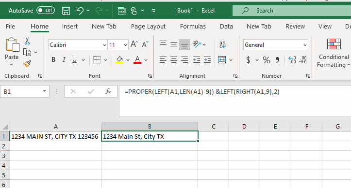

    assuming that the address will always end with <2 letters for State><space><6 characters for zip code>
    say your uppercase address is in c3,
    use the formula and copy down
    =PROPER(LEFT(C3,LEN(C3)-9)) &LEFT(RIGHT(C3,9),2)

    Hi NK_2021,
    I apologize for all the trouble it has caused and sorry about your time.
    As per your description, to add “xl_geek” reply here  is screenshot for your reference:

    That works perfectly! Thank you so much! I had read a bit about this type of formula, but have never used it so was honestly trying to save some time. YOU ROCK!
