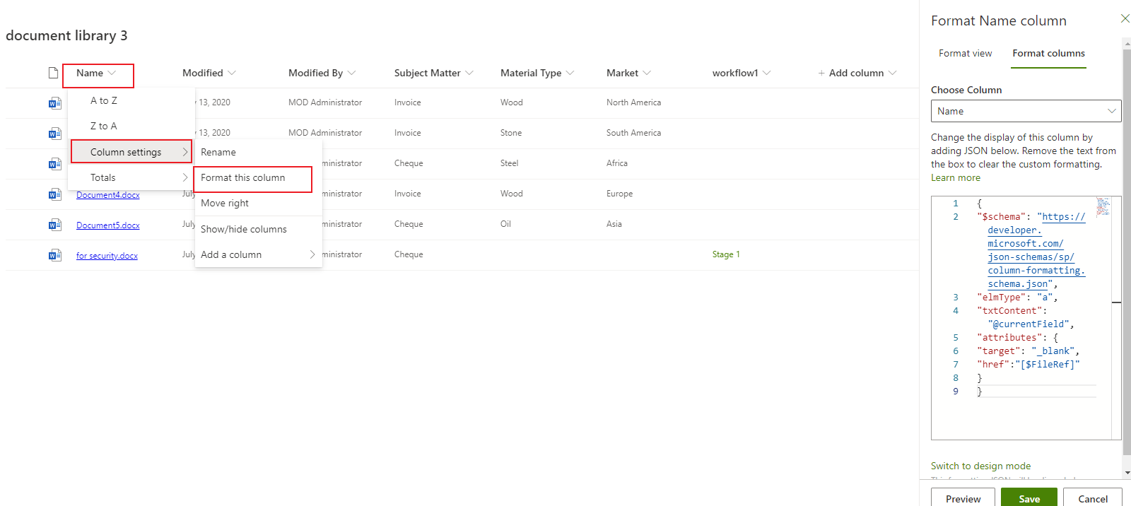

    If you want to download directly to the local when you click the file name, add the following JSON code to the library. Make sure “Opening Documents in the Browser” is set to “Open in the browser” firstly.
    "$schema": "https://developer.microsoft.com/json-schemas/sp/column-formatting.schema.json",
    "elmType": "a",
    "txtContent": "@currentField",
    "attributes": {
    "target": "_blank",
    "href":"[$FileRef]"

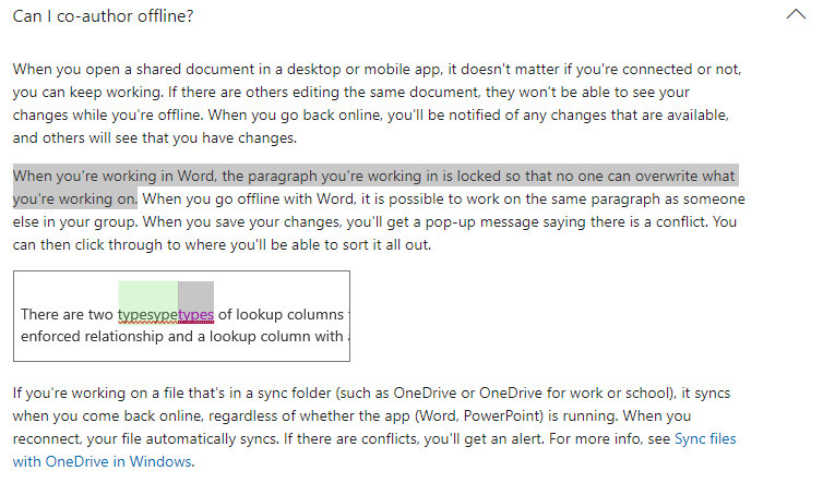

    For the downloaded SharePoint documents will be locked, which is expected behavior of SharePoint co-authoring, which is mentioned in Document collaboration and co-authoring.

    This is helpful. I will try formatting the column to be a link. That should solve the problem of people checking out and locking files while still allowing everyone to upload. Thank you for the response.
