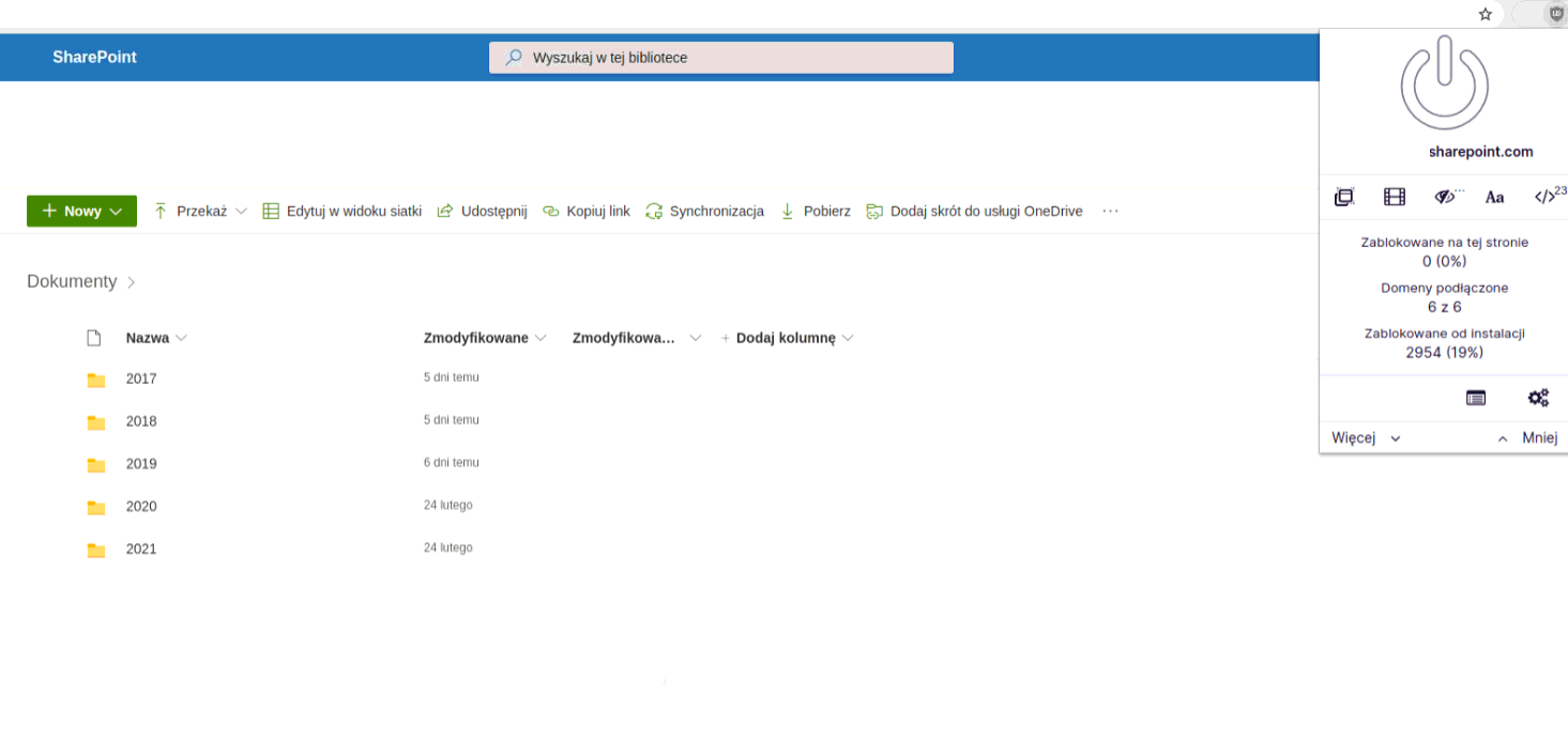

    We managed to solve the problem, I am sending a solution because it is possible that others also have this problem and the reason is a well-known browser plug called: uBlock Origin
    When  uBlock is enabled (on default settings)
    immediately after disabling the plugin  the library loads properly:

    2021-03-23T13:04:12+00:00
    Hi Łukasz Świerzewski,
    Very glad to know the library can display fine after disabling the browser plug uBlock Origin. Thank you for sharing the solution, I will mark your reply as answer, this will definitely benefit other community members who have the same issue!
