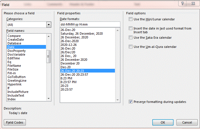

    1.
    This works for me:-
    INSERT tab
    Text group
    Click on the drop down arrow to the right of:-
    Quick Parts
     - then click on:-
    Field . . .
    The window called:-
    Field
     - should open.
    2. (a)
    In the window called:-
    Field
     - and in its field called:-
    Field names:
     - click on:-
    Date
     - (see screen shot below).
    2. (b)
    You can then in the field called:-
    Date formats:
     - choose what you want.
