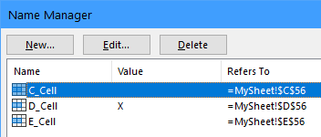

  2. HansV 462.4K Reputation points MVP Volunteer Moderator
    2021-01-14T17:46:44+00:00
    You could define named ranges like this:
    And use code like this:
    If Target.Address = Range("C_Cell").Address Then
        Range("C_Cell").Value = "X"
        Range("D_Cell").Value = ""
        Range("E_Cell").Value = ""
    ElseIf Target.Address = Range("D_Cell").Address Then
        Range("C_Cell").Value = ""
        Range("D_Cell").Value = "X"
    ElseIf Target.Address = Range("E_Cell").Address Then
        Range("E_Cell").Value = "X"
    End If
