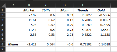

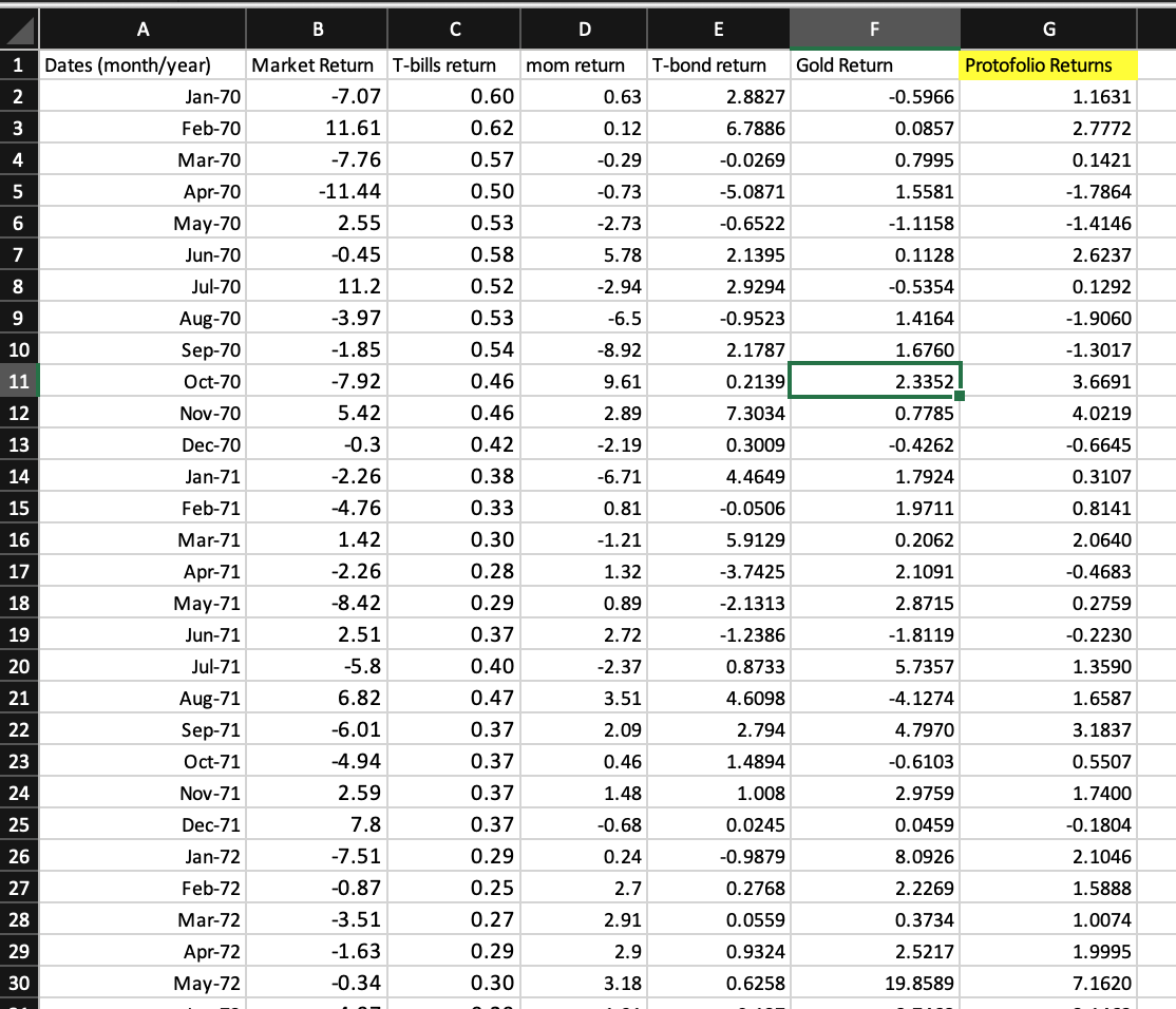

This is the data I have:
Does anyone know how I can use Solver on Excel to find the highest Sharpe ratio?
In addition, I'm supposed to provide separate answers under each of the following scenarios.
A)  All the portfolio weights must be non-negative.
B) Non-negative weights + No investment in the mom return.
C) Non-negative weights + No investment in Gold.
 I believe I need to start by creating three columns for the portfolio returns. But I'm not entirely sure how to do this. If anyone has any idea on how I can do that and answer the questions under the three scenarios, or the direction I should take to get this done. It would be so helpful and appreciated.

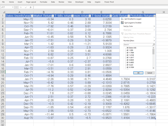

    Based on your data, I create a new sheet and I can use the sort feature to get the highest Protofolio Returns. See Quick start: Sort data in an Excel worksheet

    I am using a small sample.  Rows: 1-5 only. You have means of your returns:  ( I use range names )

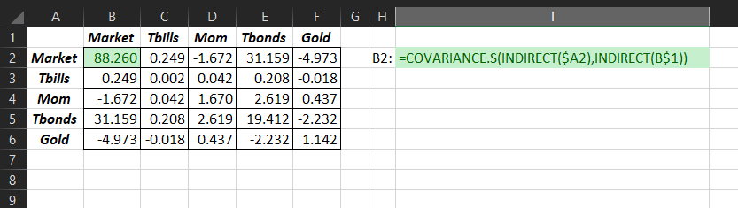

    You then need a Covariance Matrix.  I'll call this "M"

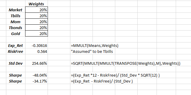

    Start with weights of 20%.  These are the cells solver will change.
    Your expected return is the weights * avr return.
    (MMULT if orientation differently, Sumproduct if same orientation. )
    I "assumed" RiskFree is the TBills.
    I am not clear at the moment if you need to adjust to annual returns or not... I don't remember.
    Here are 2 ways for the Sharpe ration.  Pick the one they mention in class.
    Solver:  Maximize Sharpe,
    Adjustable cells:  Weights
    Constraints:  0 <= Weights <= 1
    Total Weights = 1
    So, this may not be perfect, but it may give you direction depending on what they say in class.

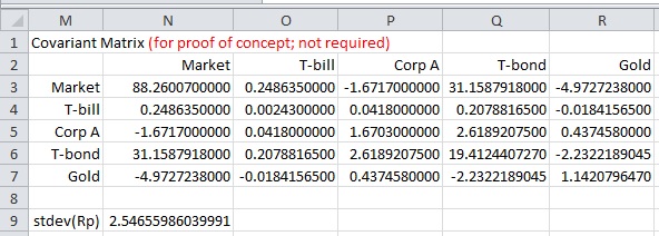

    I have never understood the need to calculate the portfolio stdev with a formula like that, if we have access to the raw data, as Farah does and Dana relied upon.
    We can avoid the complication of calculating a covariance matrix by calculating the portfolio stdev directly from the data, in one of several ways.

    As a proof of concept, compare the stdev(Rp) in G12 above with stdev(Rp) in N9 below, based on the covariance matrix.
    Formulas:
    N3: =COVARIANCE.S(INDEX($B$2:$F$6, 0, ROWS($N$3:N3)), B$2:B$6)
    Copy N3 into N3:R7
    N9: =SQRT(SUMPRODUCT(MMULT(N3:R7, B9:B13), B9:B13))
