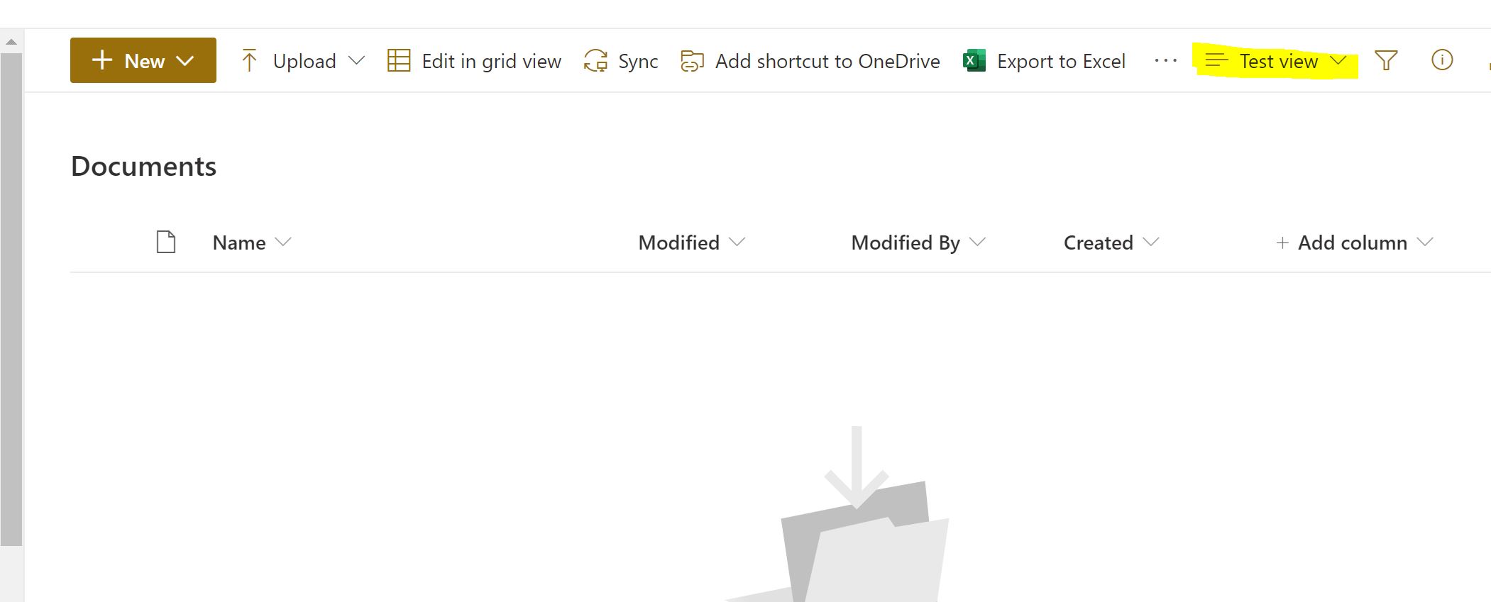

    There are over 20000 items in the library but the list items is currently at 4003, so I'm receiving the warning to say we've nearly reached the threshold. I've read the article you've attached multiple times, and have created a new list view as suggested, and made this list view the default but when I go into library settings the notification still states there are 4003 list items.
    My question is how am I meant to know if I'm going to run into performance issues? As you can see from my screenshot, it's showing my Test view and still showing 4003 items, but when I view the document library there is nothing in there. Should the warning disappear because there are no items showing when I use that list view?

    If my understanding is right, for your first question is related to performance, generally, as the number of items you added increases, the speed of opening and editing items and saving items may be affected. So if you add more and more items, the speed of opening and editing items and saving items may be affected.
    For your second question, as we mentioned above, this view may not be related to view and it is related to the items of your list. Generally, when the items in your SharePoint list is approaching 5000 items, it will appear warning message. It is not related to the new view created, it just show the entire items you created in this list, and this warning message just is a notification that your list have many items and you need to pay attention to it and avoid that situation in time. So even if you have created a new view without any items, this warning message will still appear.
