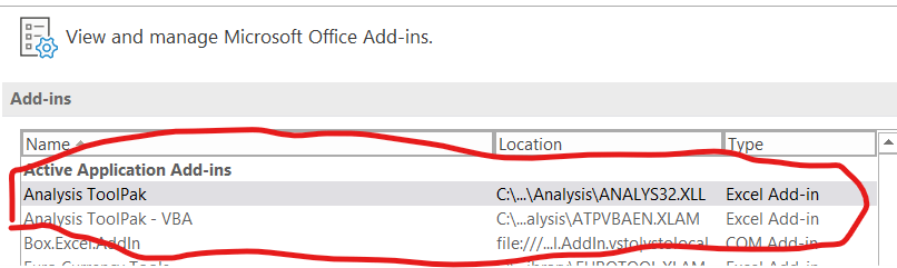

I added the Analysis ToolPak and Analysis ToolPak -VBA to the Add-Ins as below:

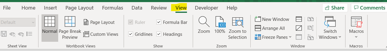

I went to the View Menu but I couldn't find the status bar option:

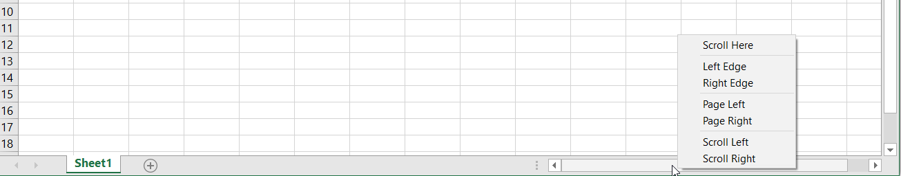

I right clicked on the Status bar but it didn't display the customize shortcut menu

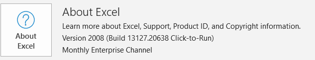

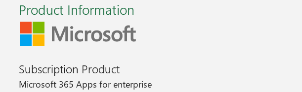

Here is the Window and Excel version:

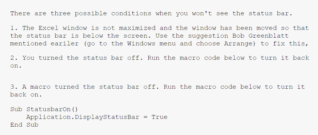

    Per your description, you mentioned "the sum/average/count are still not showing in status bar" at the beginning, however, you also mentioned "I couldn't find the status bar option", may I confirm that whether you mean that the Status Bar missing on your side?
    If yes, I found a thread which has the similar issue with you, you can try the methods in this thread which helped many users to see the result: Status bar missing in Excel 2016

    Dear Jazlyn,
    Thank you for the suggestion. Yes, I was running a macro but I am not sure how it turned off the status bar.
    I ran the macro provided by you and now I am able to see the status bar as per the screen shot below.
    One quick question; may I know if I have to run this macro all the time when I open the excel?

    2021-06-07T08:17:49+00:00
    Hi Lee,
    Thank you for the reply.
    For your question, I tested it on my side, and I found that only the files created when the macro file is opened, the status bar will appear.
