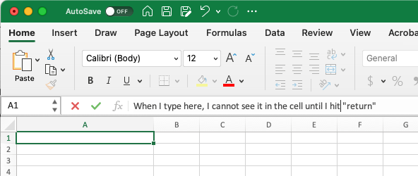

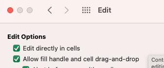

I'm currently experiencing an issue with Mac Excel 16.49 in which the text is not displayed in the cell while typing. It shows in the fx bar and then in the cell once the return button is hit. This happens on both saved and new documents. I have the "Edit directly in cells" preferences checked.
