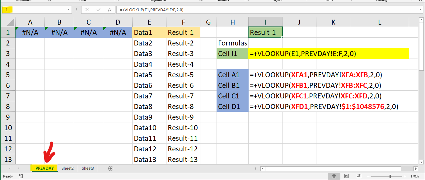

    As shown in the picture below
    1- If the active cell is in any column < 5 i.e. within columns A:D
    The lookup resulting formula will be set at the end of the worksheet ranges columns as indicated with bold RED color in the picture.
    So be aware of it, and set in the code, a message, or a command to avoid that.
    I hope this helps you and gives a solution to your problem
    Do let me know if you need more help
