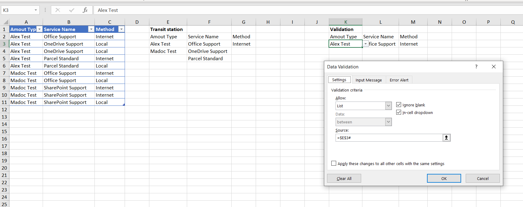

    When I test from my side, I find that we cannot directly use the formula inside Data Validation Toolbox because it cannot find the unique value from the table.
    As workaround, you may create a "transit station" which is used to firstly get unique value from the table, and then create data validation based on the value from the "transit station".
    You can find the example file from this shared link: https://1drv.ms/x/s!AqyUzW7T2xzFlheZDi_pVaNzuTS-?e=JKScX0

    Hello Tina,
    Many thanks for your reply or should I say "Christmas Gift" considering the reply date :-)
    Let me first start by Wishing you a Happy and healthy New Year for 2021. Hope the world will soon goes out of this pandemic.
    I just investigated your proposition, but unfortunately, It won't fit my need.
    Actually, as you can see on the attached print-screen, I wish to populate a form (green table) from L0 to L3 using dependent data validation, for each line of the form.
    If I use a transit station, I will need one transit station per line. It would be OK if I would have only few lines in my report, but I will have up to 500 lines in mine.
    So far, I've used a VBA macro to populate the correct "validation content" depending on the precedent cell at the selected line but I would rather prefer to rely on formula so I'm trying at the moment to build it using INDEX and MATCH function. Unfortunately I experience difficulties with filtering aspect (I do not retrieve unique result in my validation list). Also I expect formulas will become very long and complex when I will extend to L2 and L3.
    I'll keep you posted if I find a way of making it work with formula.
    Thanks for your support,
    JTO
