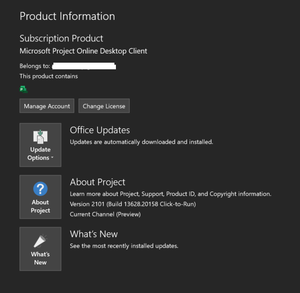

    The autocomplete function has not worked for at least a month.  I've tried researching online and have found nothing.  I have run the "full repair" option in the control panel and have even uninstalled Project entirely from my computer and reinstalled to no avail.
    This autocomplete issue is not just with the "task name" field.  It's also with notes and any of the text 1, 2, 3, etc., fields.  It does still work for the "resource name" field.
    I just now updated Project again through the account settings.  I am on version 2101 (Build 13628.20158 Click-to-Run).
    Attached is the screenshot you have requested.
    1. I have been having this issue for about a month.
    2. No I have not changed any settings that I know of, just using the software as normal.

    Please ensure sure your Office apps are fully updated. To check version information, open Project, click File>Account, check for the info mentioned under Product Information. The latest version of Current channel is 2012 (Build 13530.20376). For other channel version info, see Update history for Office 365 ProPlus.
    If the version is not updated as mentioned in the article, please install updates and check if the issue remains. To know how to install updates, see Install Office updates.
    If the issue persists,****please provide us with the following information:
    1. Please provide the screenshot of Project Product Information. To get this screenshot, open Project on your system, click File>Account, capture the screenshot of all the information mentioned under Product Information.
