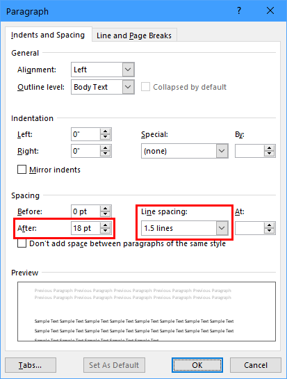

    Instead of inserting blank lines, do the following:
    • Right-click the Normal style in the Styles group of the home tab of the ribbon.
    • Select Modify... from the context menu.
    • Select Format > Paragraph...
    • If you want to increase the space between subsequent paragraphs, increase the Spacing > After amount. You can specify the amount in pt (points), cm (centimeters) or in (inches). For example: 0.25 in
    • If you want to increase the space between lines of the same paragraph,set Line spacing to for example 1.5 lines or to Double.
    • Click OK.
    • If you want to apply this to all new documents. click 'New documents based on this template'.
    • Click OK.
