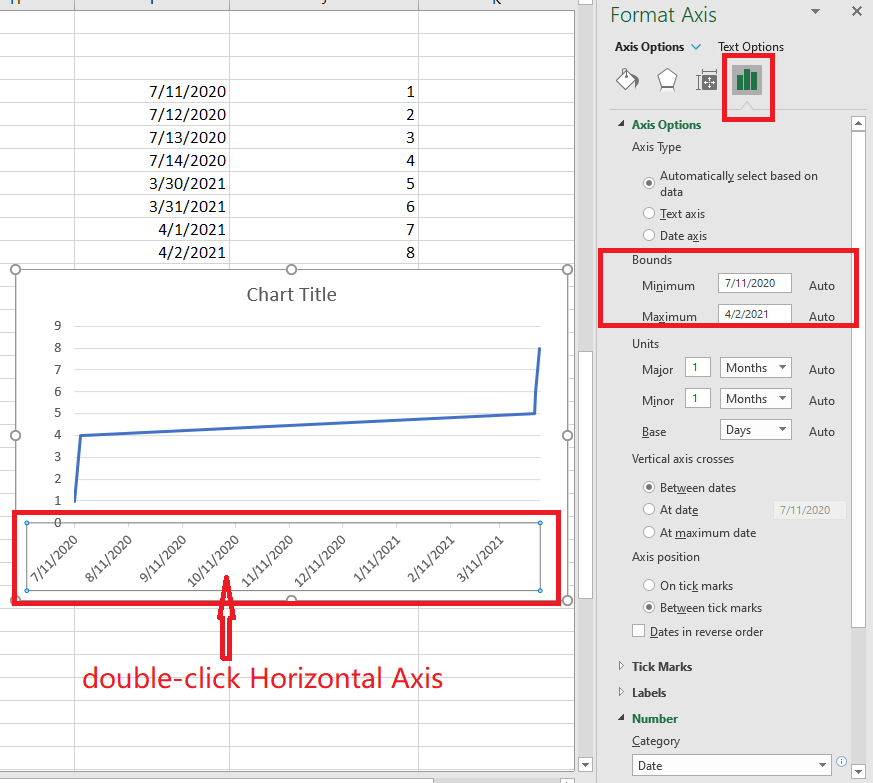

I'm making a line chart on excel, and want the date to start at 07/11/20 and end today. However, the dates shown starts at 01/01/00 and ends at 11/16/00. How do I make excel show the right dates? Note: the right dates are shown on my table, but are wrong on the chart. Also note that there are some dates with multiple data points and some dates skipped.

    Per your description, we test on our end, and it works well. So, we would like to suggest you can double click the Horizontal Axis to open the Format Axis window > click Axis options to see the Bounds, like the below screenshot.

    2021-04-02T01:02:09+00:00
    Thanks.
    The first option did not work as Bounds and Units were not given as an option. However, when I opened up a new workbook, the time line was properly charted. I'm not sure what the problem was.
    Version 16.47.1
