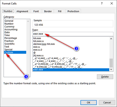

    2021-03-07T04:03:39+00:00
    Hello Dave,
    Thank you for getting back to me on this. I also thought that would work. But my problem her is that that doesn't work with the Alpha Numeric information that I am currently working with. The Alpha Numeric characters I am using are also in no logical sequence or order. They are specifically license numbers that I am just trying to make them easier to read by grouping smaller sequence of numbers if you will.

  5. DaveM121 891K Reputation points Independent Advisor
    2021-03-06T18:00:27+00:00
    Hi R626
    I am Dave, an Independent Advisor, I will help you with this . . .
    Select those cells, right click and choose Format Cells
    Select Custom and in the 'Type' box, enter this manually: ### ###
    Click OK . . .
