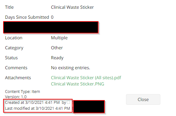

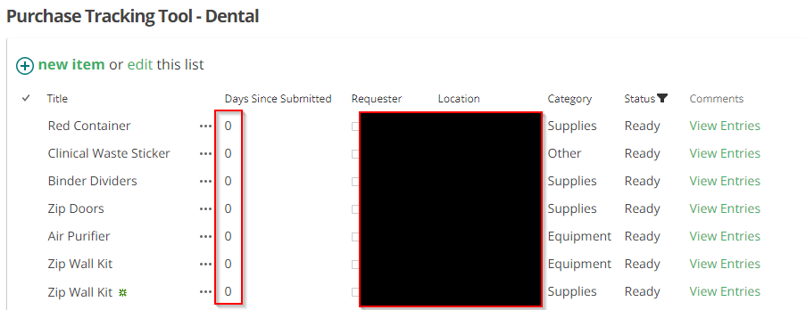

There is a list on SharePoint that I am working on where the "Days Since Submitted" field is updating correctly from when the items have been created.
I checked the list settings and found the column had this formula, which looks correct:
=DATEVALUE(TEXT(NOW(),"mm/dd/yyyy"))-DATEVALUE(TEXT(Created,"mm/dd/yyyy"))
I also compared and contrasted another SharePoint list that hasn't had these issues and the coding is exactly the same.
I checked the dates these items have been created and they are all showing as "0" days since submitted.
Is there a bug with the system? Or is there something that could be causing the field to not update?
Here are screenshots below:
Please let me know if there are any other questions, comments or concerns.

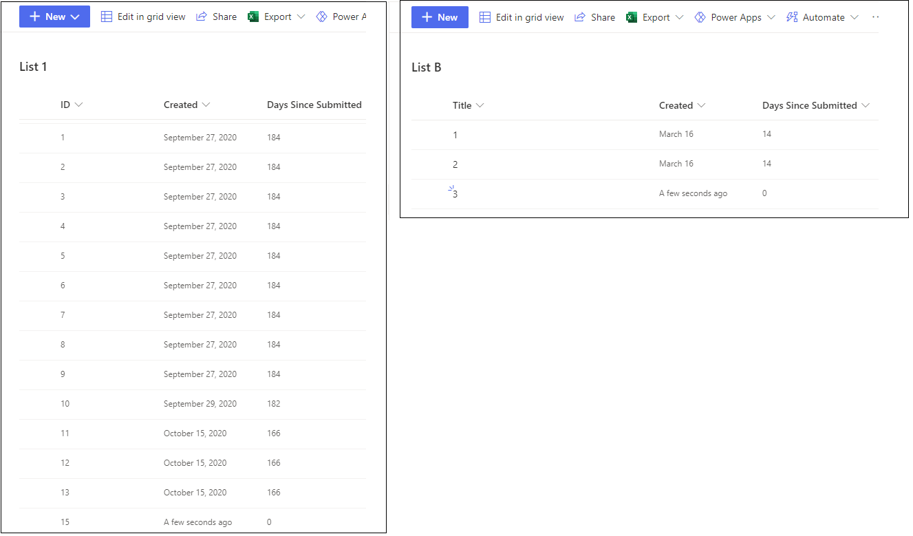

    Hi Ivan,
    I tried your formula and I saw the correct result in both my lists, here’s a screenshot for your reference.

    Hi Neha,
    Sorry for the late response. I did try switching from classic to modern with no difference made.
    Let me check again on column settings.
    2021-04-02T15:56:42+00:00
    Hi Neha,
    Okay, I changed the data type returned to "Single line of text" as opposed to "Number."
    This has fixed the issue.
    Thank you very much for your assistance!
    This can now be marked as Resolved.

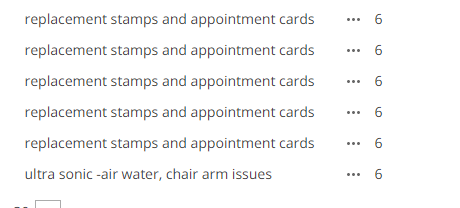

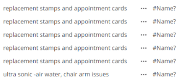

  5. Anonymous
    2021-06-28T22:17:52+00:00
    So we have tried this method and while it works for a temporary amount of time, eventually it will stop working again.
    After a while, "Days Submitted" field will contain "#Name?" instead of the actual number of days submitted since.
    Changing the data type to Number then back to Single line of text would work but this still does not solve the issue.
    We don't want to just keep on changing the data types to make sure the number appears again.
    Here is how it looks like after we applied the changes.
