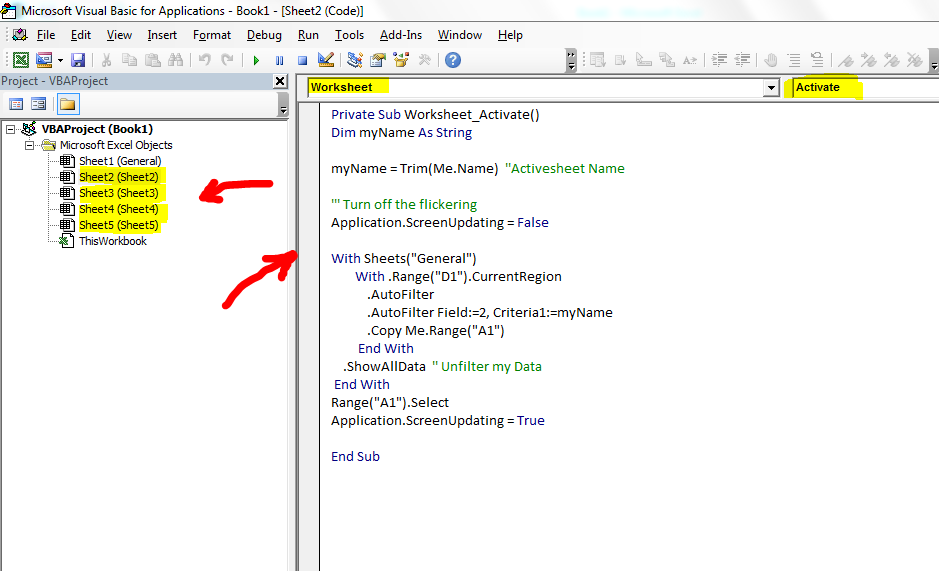

    IMPORTANT
    The code below DOES NOT belong to a regular VBA module, it goes on the WorkSheet Event VBA panel
    Please, paste the code on each of the relevant sheets for the filtering criteria as shown in the picture below
    Here is the code
    Private Sub Worksheet_Activate()
    Dim myName As String
    myName = Trim(Me.Name)  ''Activesheet Name
    ''' Turn off the flickering
    Application.ScreenUpdating = False
    Me.Cells.Clear
    With Sheets("General")
            With .Range("D1").CurrentRegion
                .AutoFilter
                .AutoFilter Field:=2, Criteria1:=myName
                .Copy Me.Range("A1")
             End With
        .ShowAllData  '' Unfilter my Data
     End With
    Range("A1").Select
    Application.ScreenUpdating = True
    End Sub
