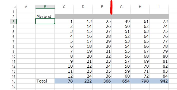

I am trying to come up with the code that will hide columns for a material summary sheet if the total for that column is zero. (ie if that column is not used i want to hide it).  see the attached image as an example.
i have a simple If code that works but my spreadsheet has 60 columns of data that would need to be checked and i wanted to see if there was a faster way than what i have:

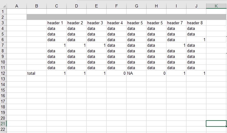

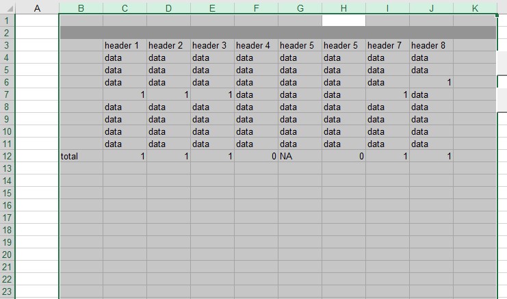

    I realized i mis-typed my question, my goal is to hide the columns when the total row shows 0. i have reworked the code slightly but now i am having a new problem. Because the spreadsheet has merged cells at the top, whent he code runs it ends up selecting everything below the merged cell rather than just the single column. I have been trying to figure out how to collect the specific column based on the selected cell but i havent had any success
    in this example id like to hide columns f and h.
    here is the code i have. the named range "totalrow" is cells c12:j12 in this case
    and the issue im having when i run it, i need it to select the single column where the total = 0 and hide that column

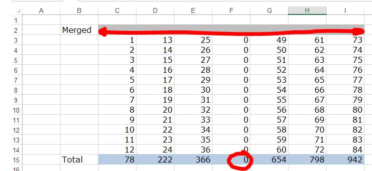

    With the code that I posted, changing
        For lngC = 1 To ActiveSheet.UsedRange.Columns.Count
    to
        For lngC = 3 To ActiveSheet.UsedRange.Columns.Count
    so that A and B don't get processed.
    BEFORE (Column F has 0 as a total):
    AFTER (Column F is hidden):
