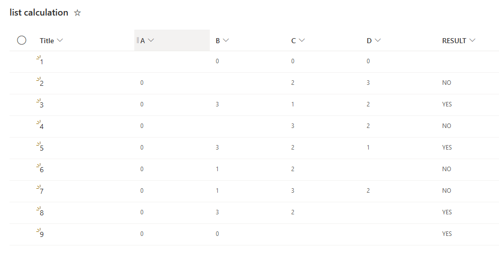

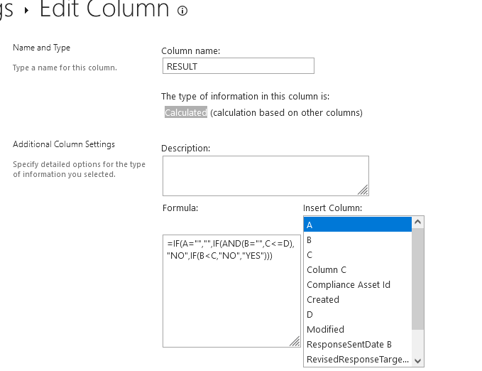

    Moreover, we created another 4 single line text columns named A,B,C and D with a Calculated column named RESULT. Here is the formula and the result we got:
