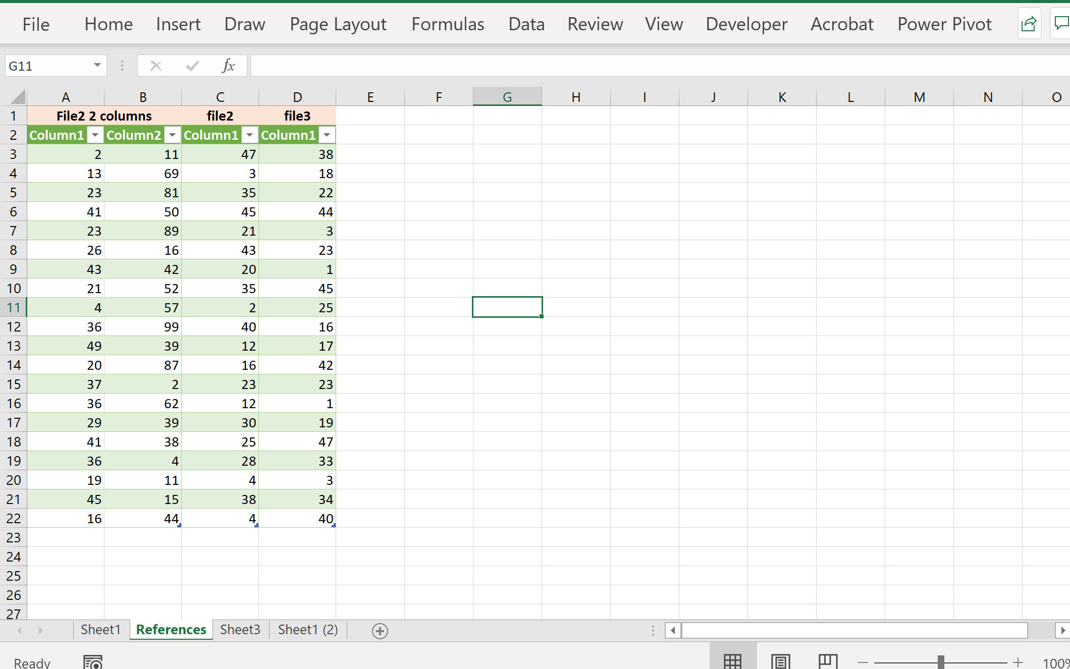

    The only way you can create references to files that are closed is by using VBA, or Power Query.
    I don't like using VBA if a solution can be had using existing tools, so if your version of excel is 365 then I would use Power Query.
    Screen Shot of files 1-3 queried and loaded into a sheet called References:

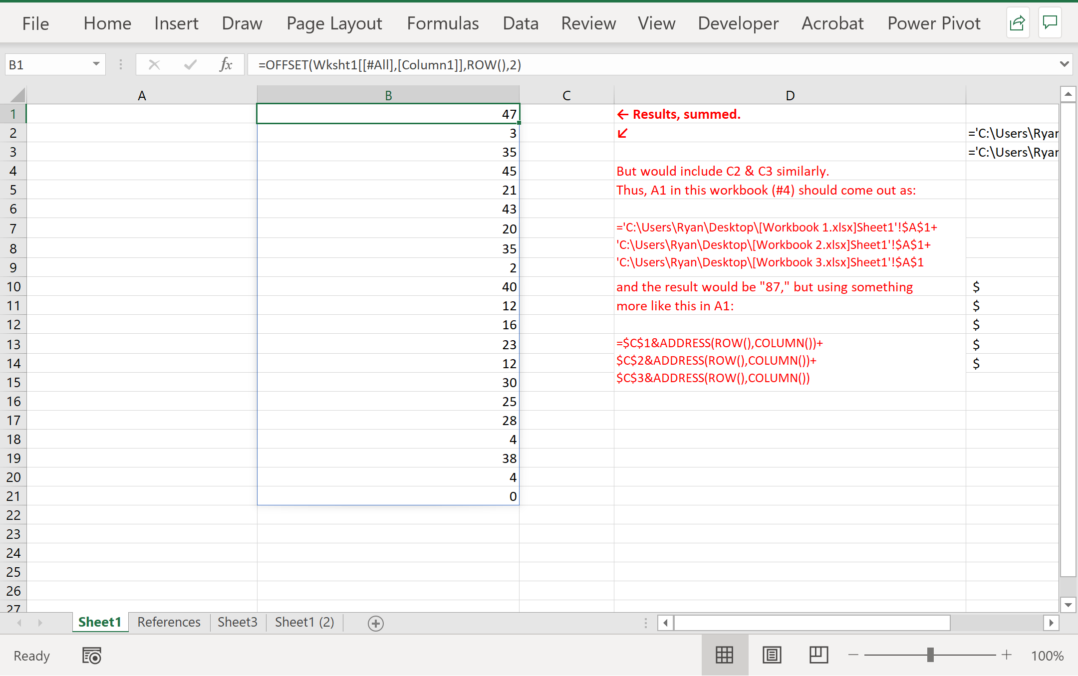

    when you reference using OFFSET() function, it will yield a spill range which you will have to manipulate further to get the specific value based on possibly a label:

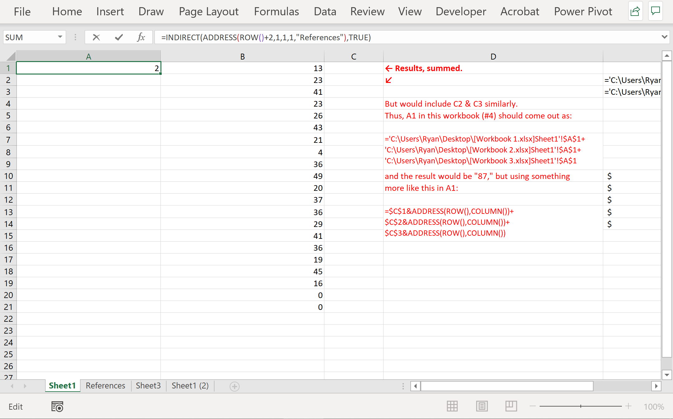

    however if used with INDIRECT()+ADDRESS() functions, it returns a specific value:
    So your solution would be:
    Power Query + INDIRECT() + ADDRESS() functions

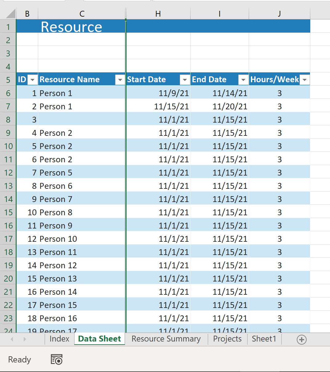

    I only use functions that even though the result of a certain function in the earlier stage of the formula progression result "SPILLS", the final outcome of the formula in its entirety does not have a spilled range returned value. Functions that return a spilled ranges are helpful in dynamically filtering a range for a desired result, i.e.
    types of data sets that involves date ranges such as this:
    the only way to get the MAX(EndDate)-MIN(StartDate) for Person 1 is to use a formula that returns a spilled range and no other way in formula form except to physically query the data set and create a table that a formula can then be created from the resultant table.
    So Functions with spilled ranges allow the user to create a formula based on ranges without having to query and create a physical table to derive its calculations from it.
    So formula minus the physical table range but instead use a "Spilled Range" (virtual table)
