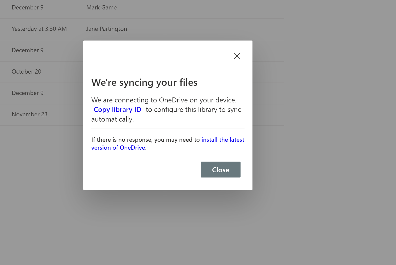

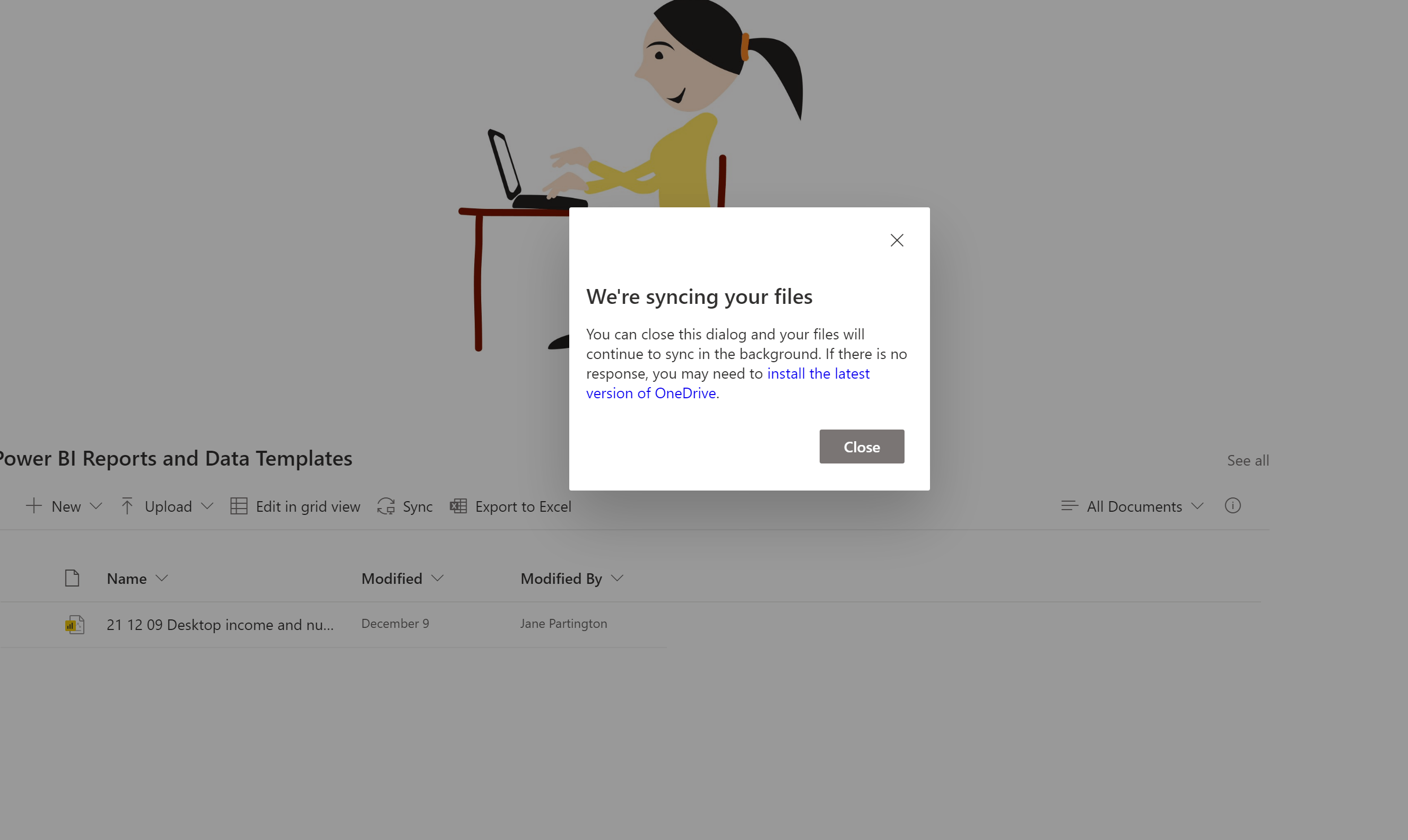

I have synced my one drive files with my computer successfully and all the folders are showing in file explorer. However, the same process does not work with my Sharepoint libraries. I am selecting 'sync' and sometimes it says 'copy library ID' but that link does not work. Sometimes it just says 'syncing' but nothing happens.

    1 and 2) all sharepoint libraries have the same problem - they will not sync. However, only one his showing the 'copy library id' dialogue box. The others have a simpler dialogue box - I am attaching two screen shots.

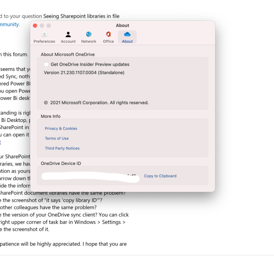

    2. screenshot of one drive attached.

    4. Could you provide the version of your OneDrive sync client? You can click cloud icon at the right upper corner of task bar in Windows > Settings > About and provide the screenshot of it.
