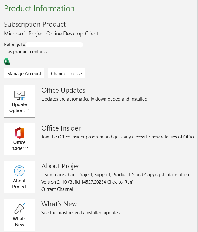

    In addition, I also did a simple test from my side to use Project files that are saved in OneDrive sync folder in file explorer. I can insert subproject. Below is my test.

    2.Are you using Project desktop application and then get the error message? If yes, could you let us know your Project app version? Please go to File>Account, capture  a screenshot of Product Information, as shown below.
